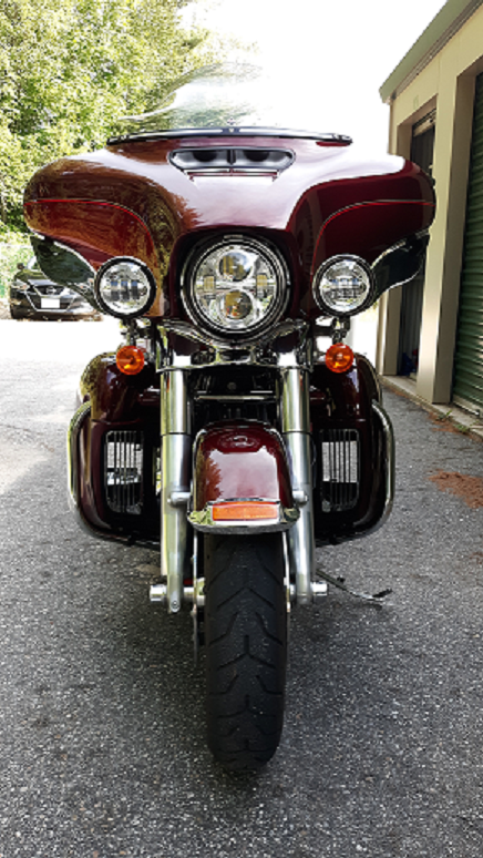

do you feel more heat with lowers? probably.
does that mean the engine is overheating? probably not.
we're getting ready to go into winter. with the lowers on, you're going to be much more comfortable. although i'm in Louisiana, i've worn my chaps 0 times over the last 3 winters because the lowers keep me much more comfortable.
i've noticed a little more felt heat in stop and go traffic in the summer, but not while moving. and like has been mentioned, the screens from the twin cooled lowers will allow more airflow. and they're cheap. about $30 for the both of them.

Do this. Take out blanks and get grills. Take out the storage boxes in lowers too for more airflow. Remove doors all together. Much more airflow. It's a little chilly on 45 degree mornings but your motor will thank you.
