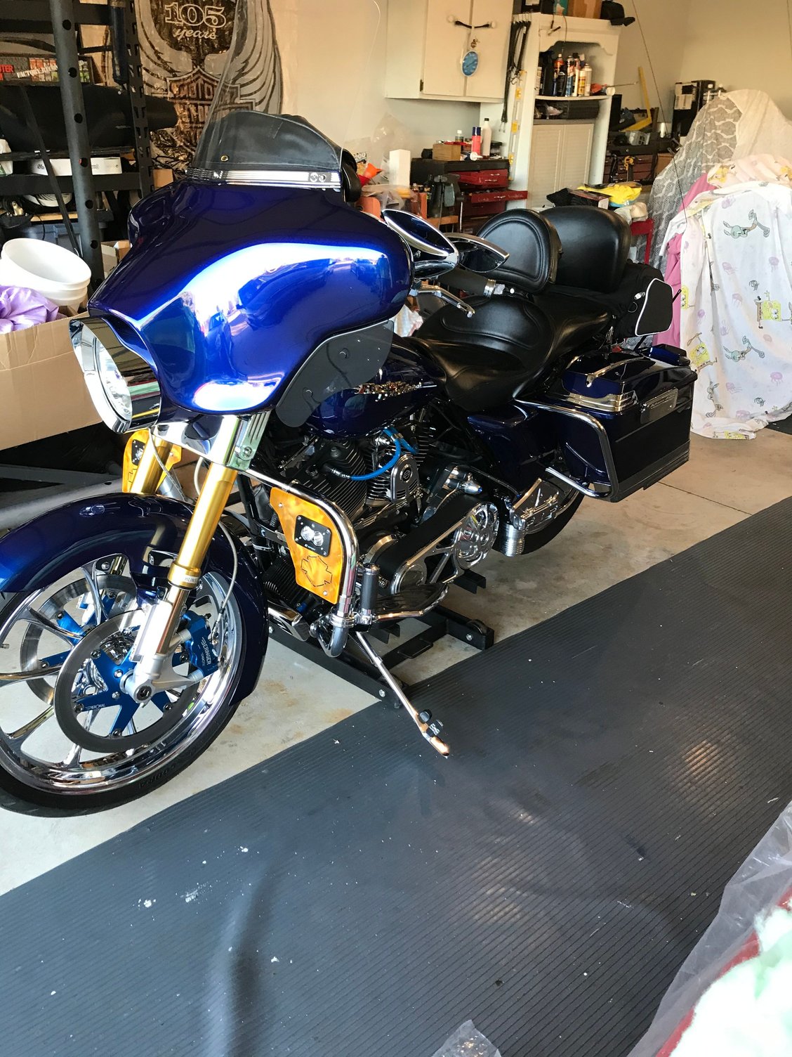

I have tried many different rotors and calibers over the years.
Im sold on Beringer.
Not the best picture I run them front and back
Beringer is good stuff.

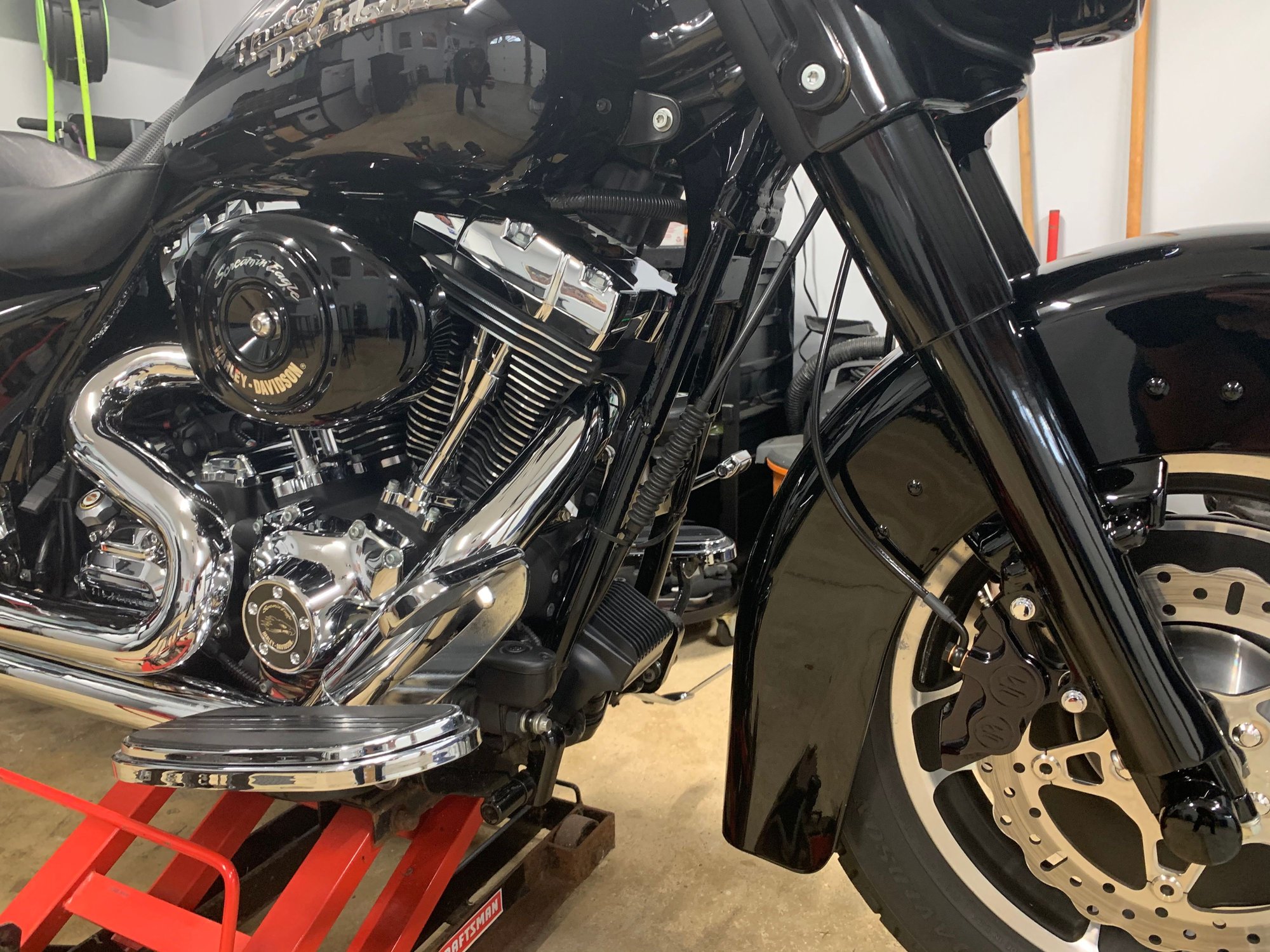

Last picture is just me comparing the stock vs the EBC
