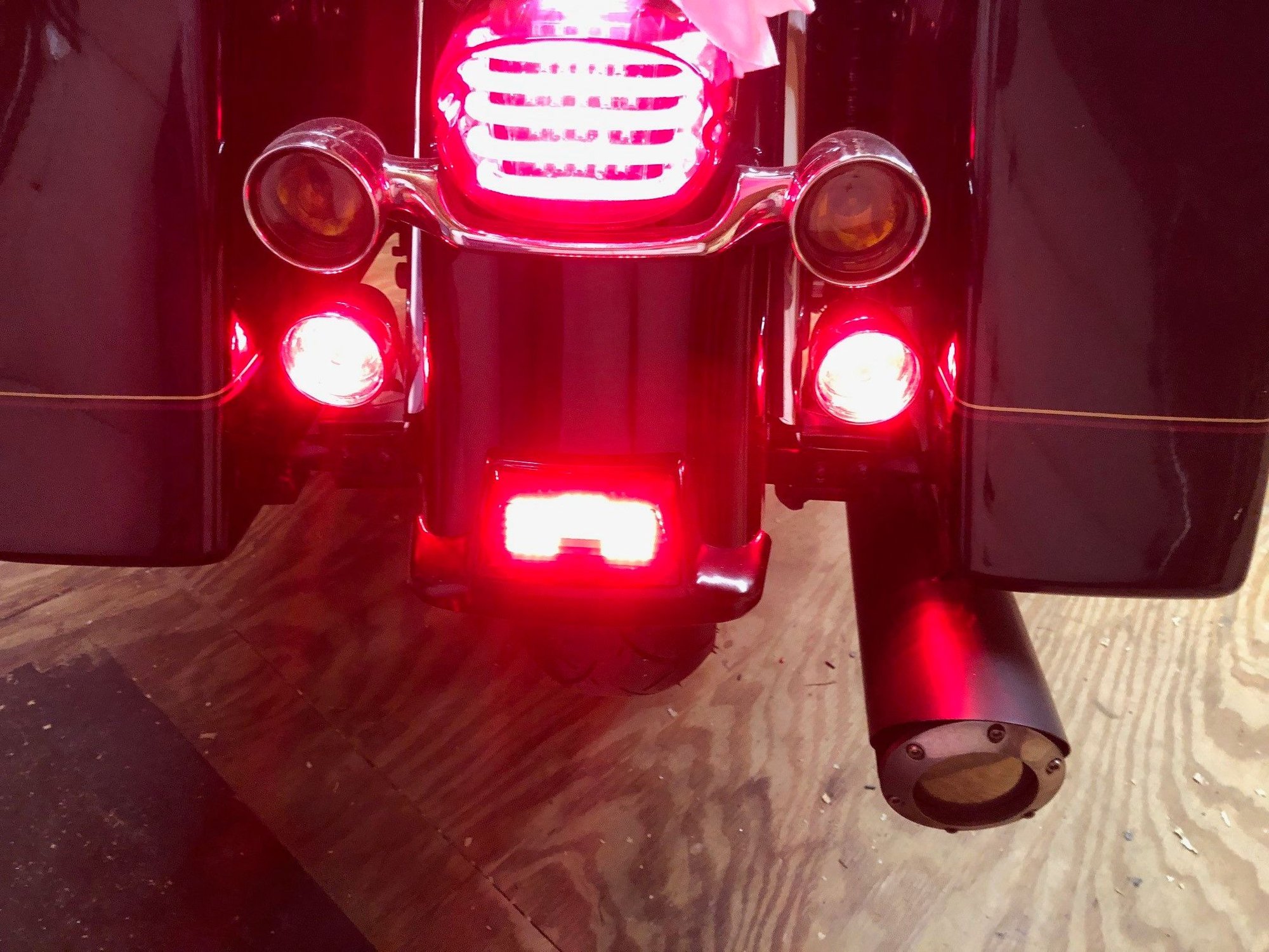

I’ve got an ‘18 Ultra Limited and pretty much don’t like the funky tip on the rear fender. I think it’s made of plastic and looks chrome, but I was thinking about painting it black and was wondering if anyone else has done this?
Looks like my options are to leave it as is, replace with Custom Dynamics lighted tip, or paint it.
Thought I might paint it and if I screw it up or it just looks bad after the paint job, then go another route.
Any feedback on your experience as well as suggestions and ideas welcomed. Thx
