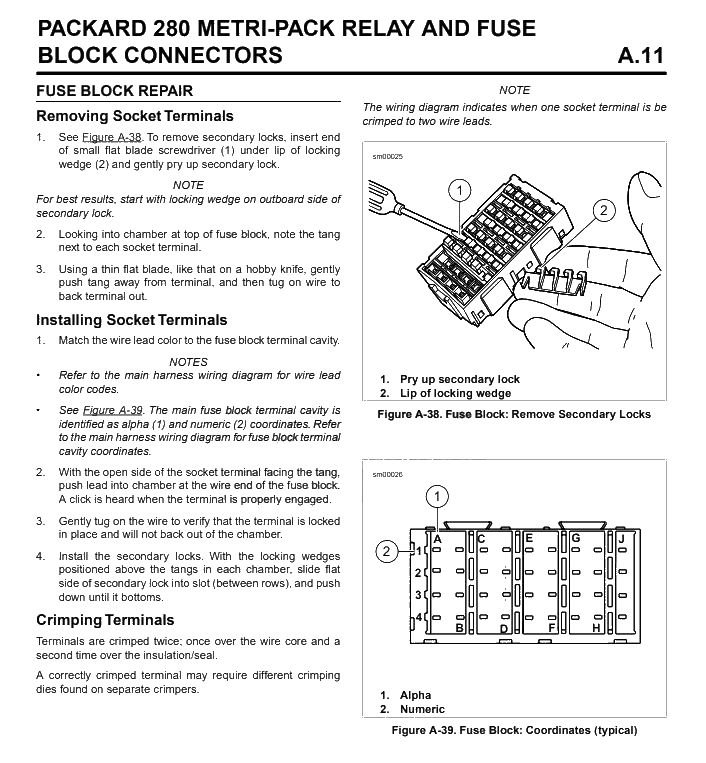

Can anyone please tell me how to get the wires out of the fuse box. I’m trying to install the wiring for acr’s and can’t for the life of me get the wires to release. Thanks

Off hand, as I recall, you have to pry that orange retainer (secondary lock) out first.
(yes, it just pries out)
Then insert something like a jeweler’s screwdriver either under or over the connector to release the primary lock (push the tang away from the connector), then pull connector out from the back.
Be advised, some of those connectors are one piece with 4 connectors.
So you would have to release all of them.

I did this installation about 5 years ago. The fuse block part was the hardest and most time consuming. Maybe this will help.

Thanks guys. Got it.
