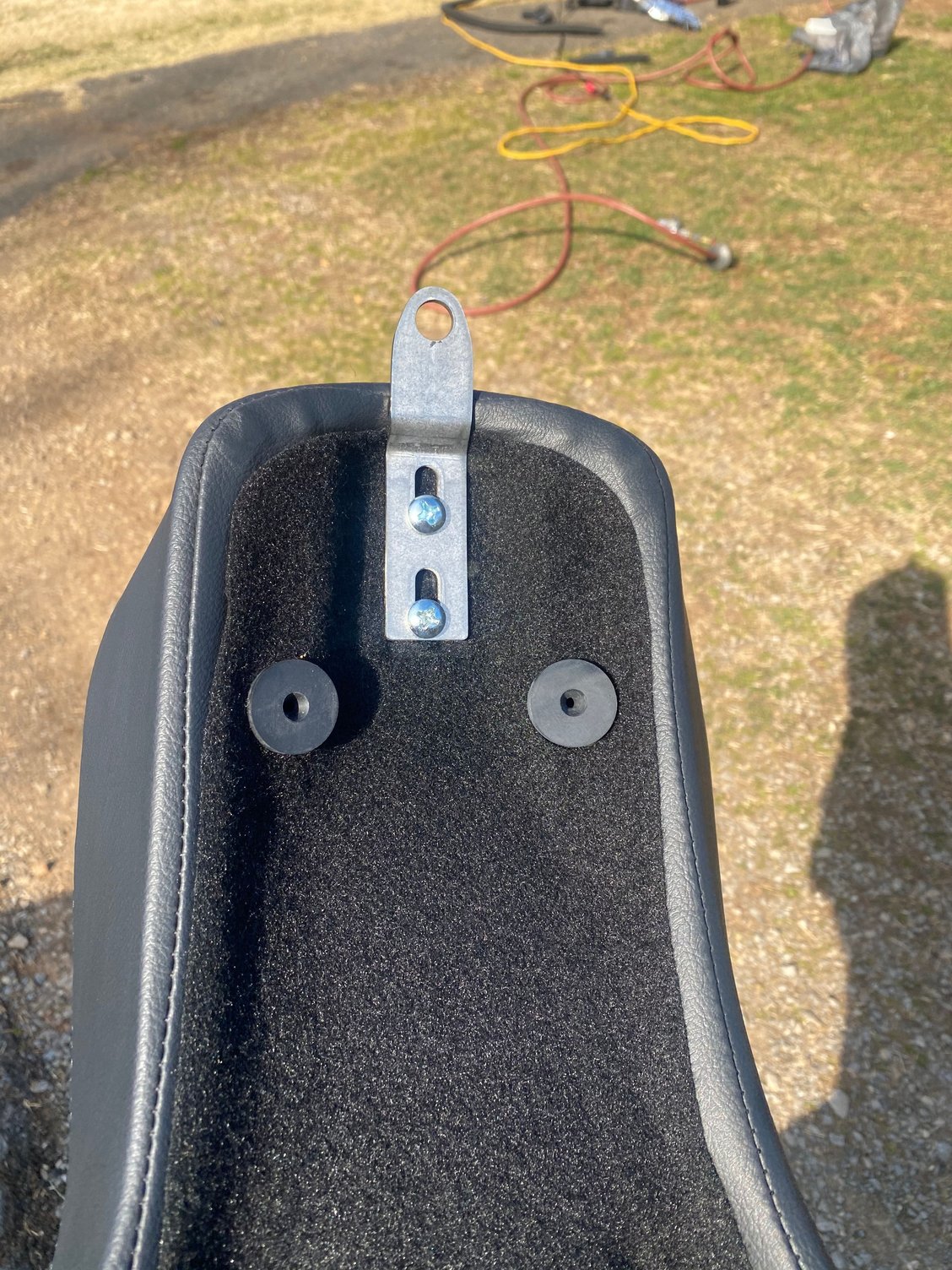

Have you looked to see if the rear mounting tab is adjustable? Meaning, there may be a screw on it that can be loosened, you install the seat and push it all the way forward, line up the tab to rear mounting hole, remove seat, tighten screw to mounting tab, install seat/rear screw and go ride..

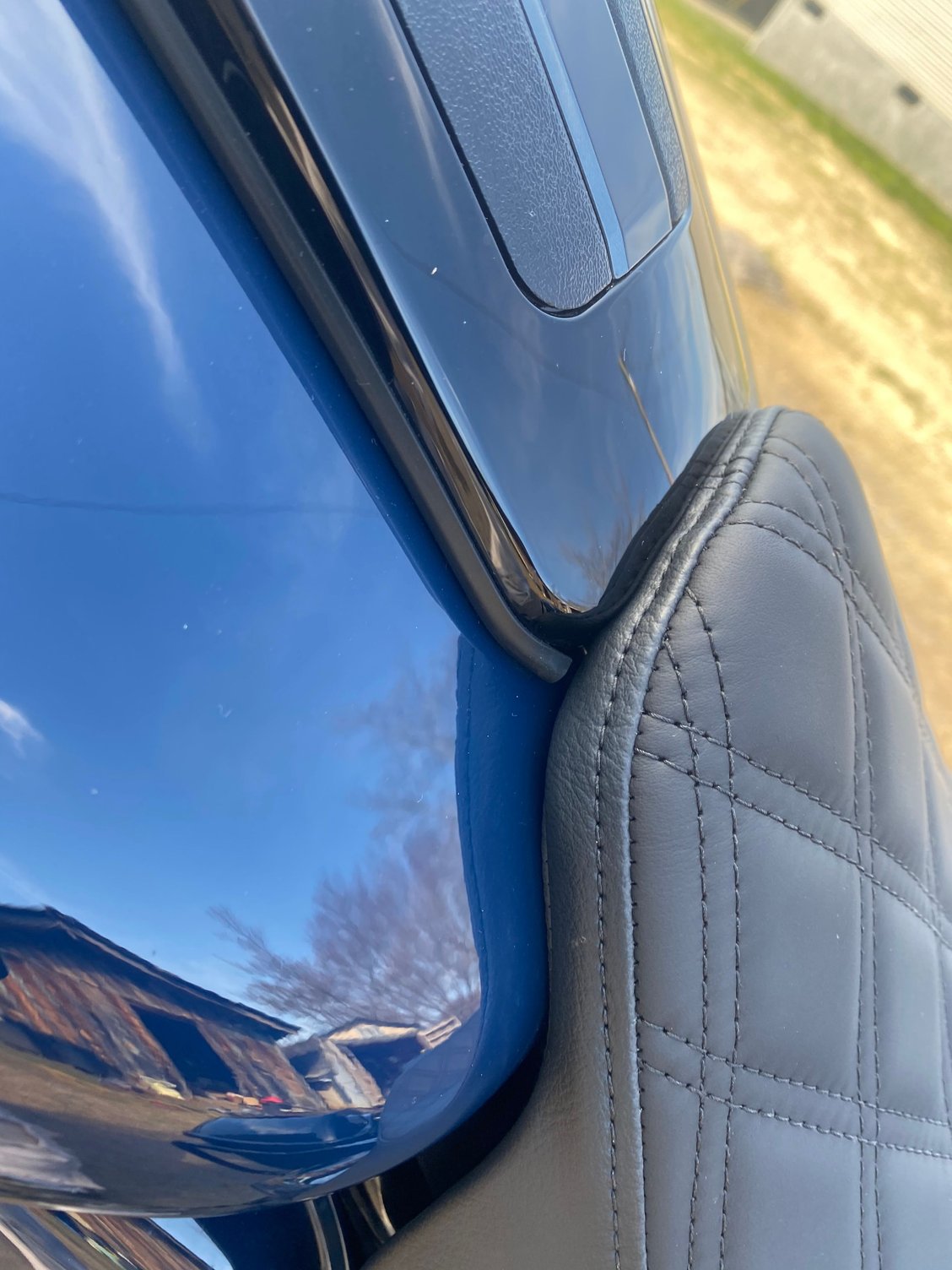

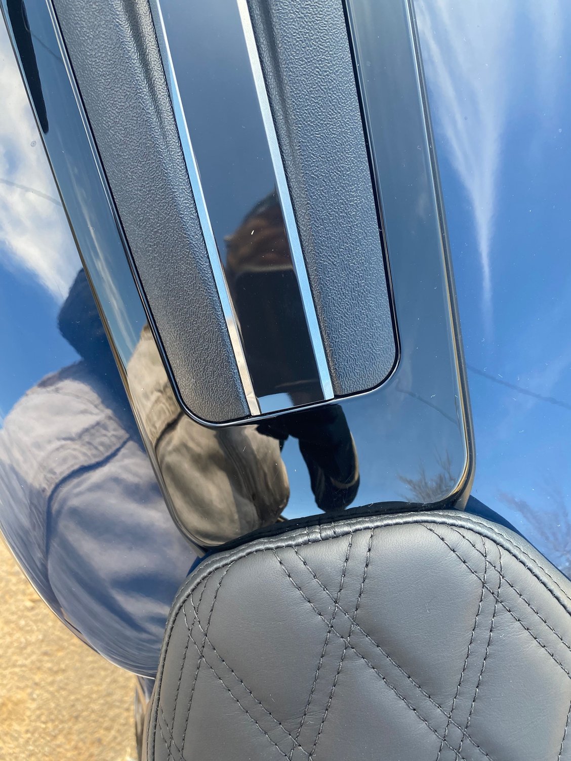

Hey ford turns out you were right about the rear mounting tab being adjustable...I finally got a chance to take the seat back off and sure enough found it was adjusted all the way back. Pushed it all the way forward and now it’s perfect:
Filled the gap nicely. I should pay closer attention man I didn’t even notice it when I first put the seat on !
Anyway, thanks for all the replies...
This is what happened to me. I had the gap, was frustrated I couldn't use the aftermarket seat screw either....then i flipped it upside down and noticed the slider the rear tap is mounted on, adjusted with a screwdriver and I was all set with a perfect fit.
