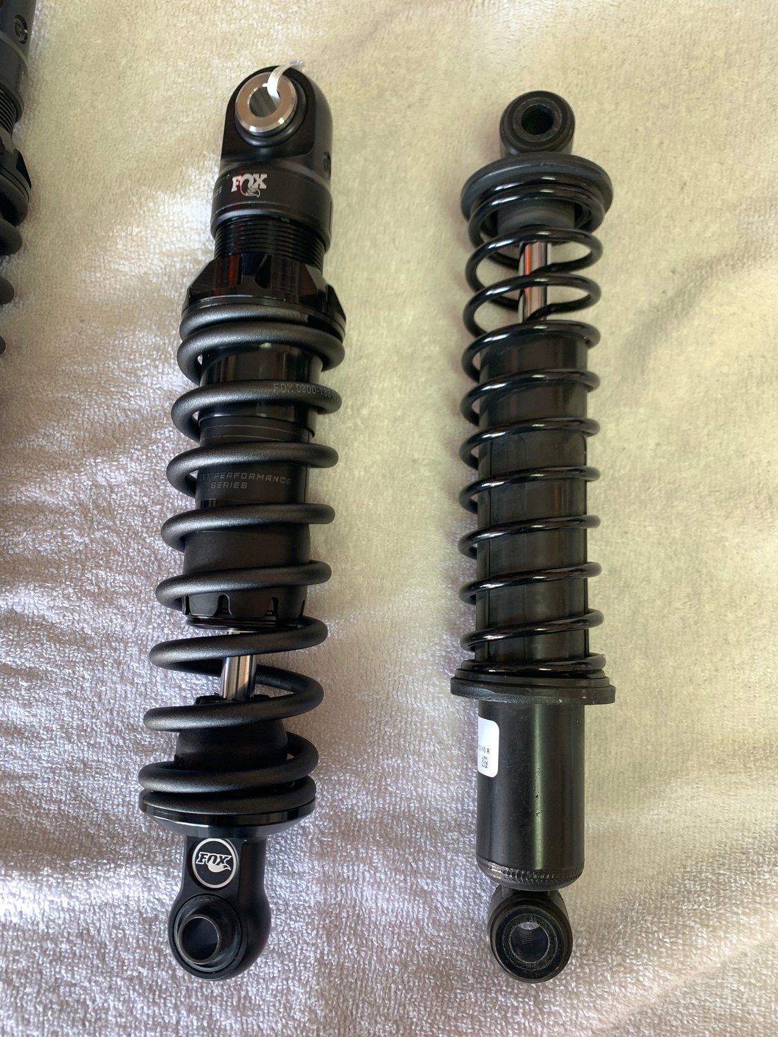

I don't know how they compare to the higher end shocks like Ohlin, but for half that price I sure like them. I got a set of the Fox Shox IFP Preload Adjustable Heavy Duty Shocks 12" Rear #897-27-101 off eBay from Parts Giant and installed them this afternoon.
What a huge difference. You guys were right, the stock sucks way more than I thought. I hit a nasty dip in the highway in AZ last Sunday, and my back is still sore from that hit.
I've been converted, and am now a believer.

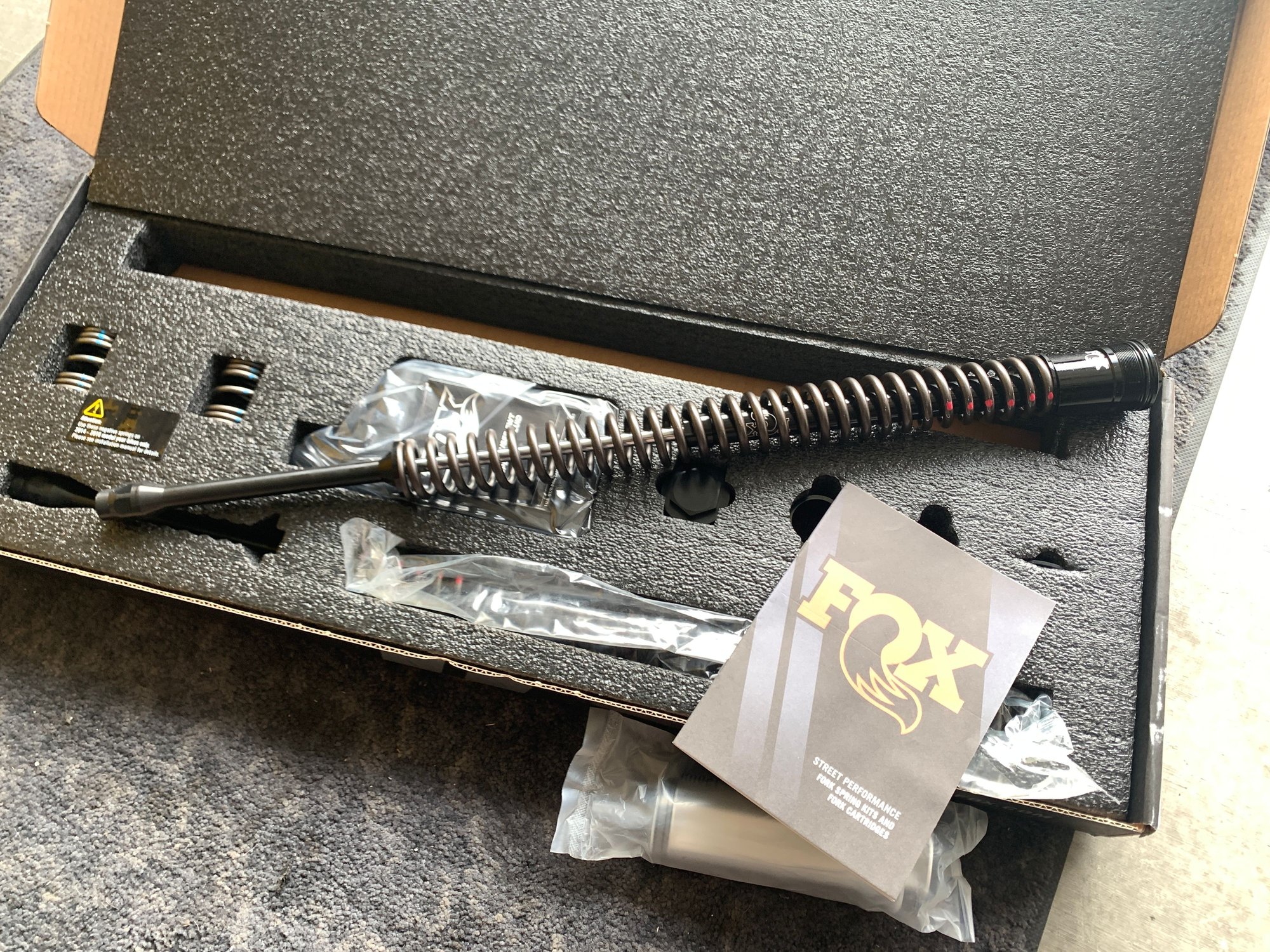

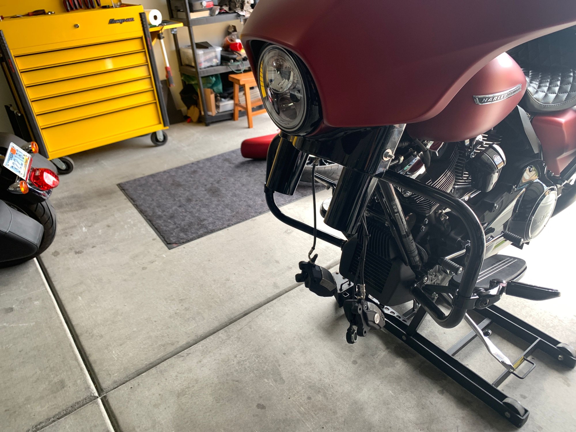

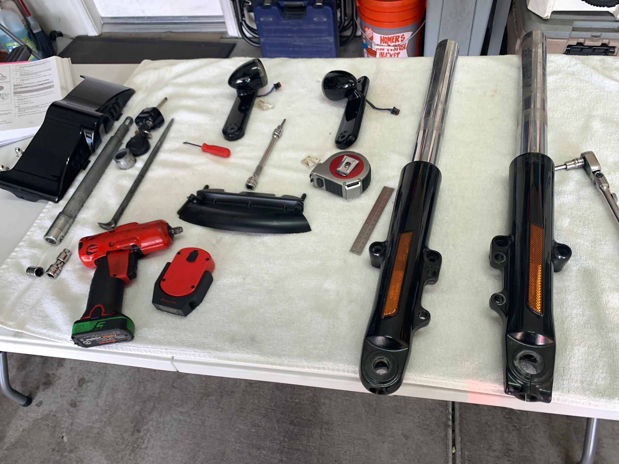

I did the front today - 30 minutes to tear it apart, 90 minutes to install the Fox components, 75 minutes to reinstall the fork legs because 2 friends showed up and we BS'd while I was working.
Are these the most underrated shock on the market? I don't know, but I sure like them. Very smooth and firm, but not at all harsh like the factory springs.
Special thanks to @Parts Giant for the great deal on these shocks.

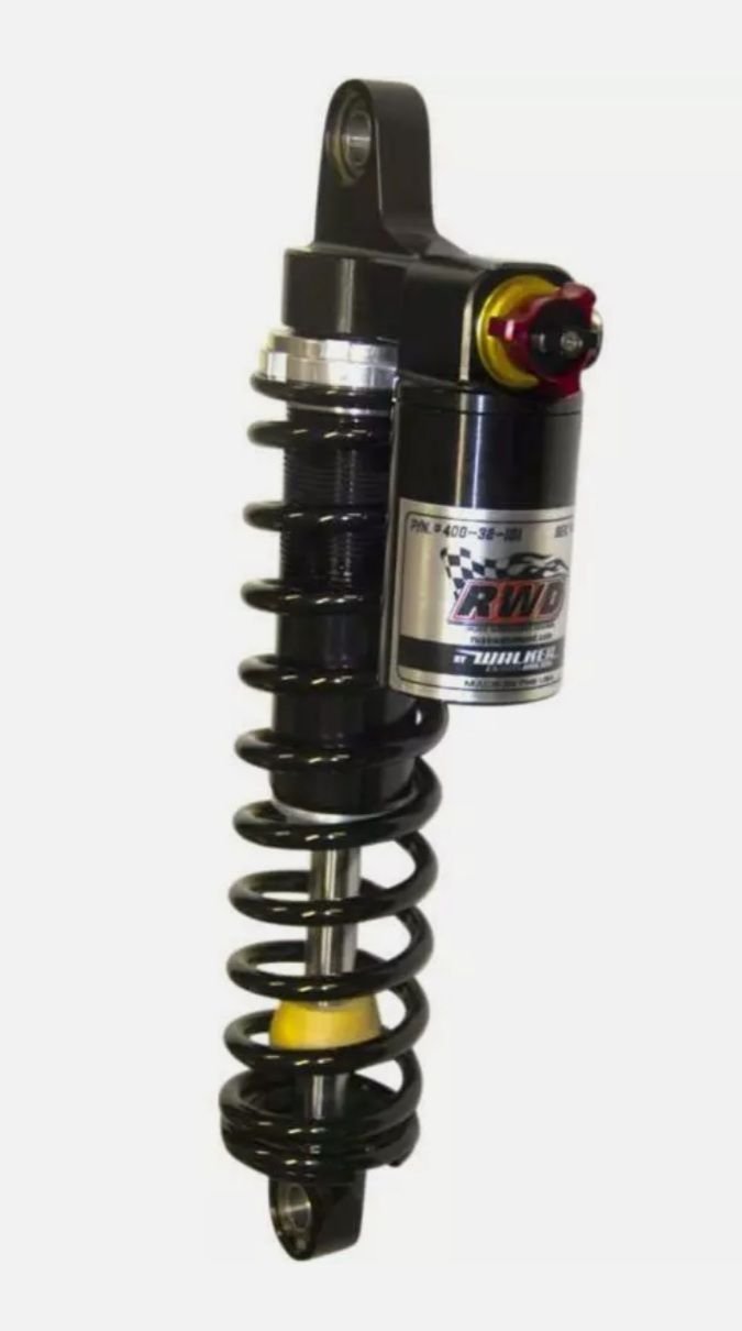

I believe they are very under rated. I had those Fox shocks on my Dyna. At the time, there was very limited information about them, but I decided to go with them. The way I looked at it was Fox is a very reputable company who'd been making shocks for a while. So what could go wrong. I really enjoyed them on my dyna. I never got around to doing the fronts. They hadn't come out with the cartridges until recently. I really considered doing fox front and rear on my road glide, but I wanted a little more high performance so I decided on the RWD. ENJOY!!!

The thing is if your going to go with an aftermarket shock, I would look at the shocks length of travel. The Fox shock is about the same as the factory shock, about 1 3/4" while the RS-1 is 4". That makes a huge difference in the ride quality and how firm the spring has to be to keep the shock body off the bump stop..... I like Fox shocks I run them on my Jeep, I was just looking for more on the back of the bike.....
