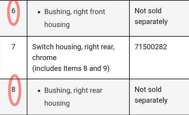

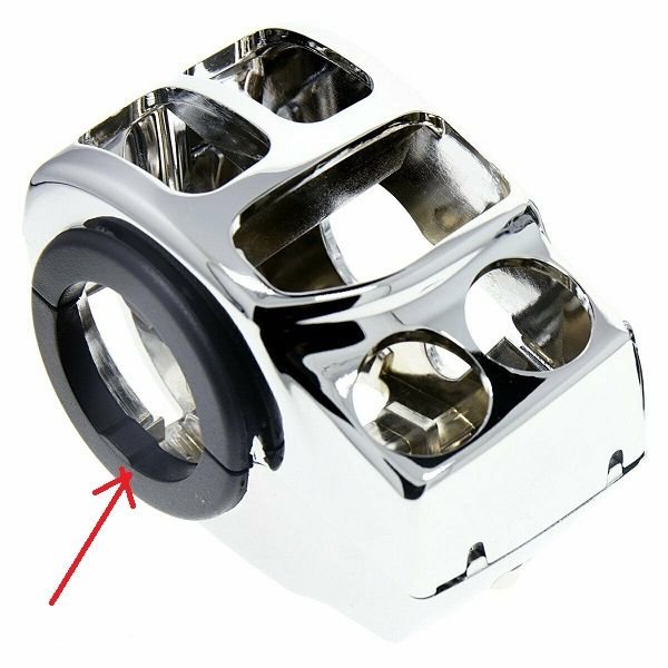

but there is a big gap between switch housing and throttle grip.
Do you part number of plastic ring shown on pic ? thinking to install to eliminate gap.

Originally Posted by barneyboy
Thanks, but Not sold separately ..

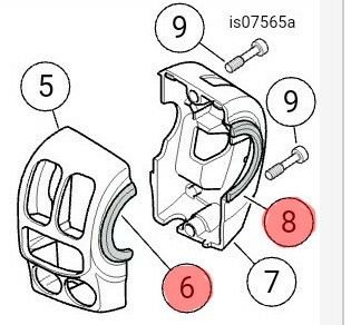

That was my point, there is no separate part numbers for the bushings. The only way to get your hands on them is to order the front & rear housings, then the bushings are included.
When you changed grips, did you retain the OE black switch housings? The housings, along with the front brake master cylinder can be loosened, and adjusted outboard to eliminate the gap.
