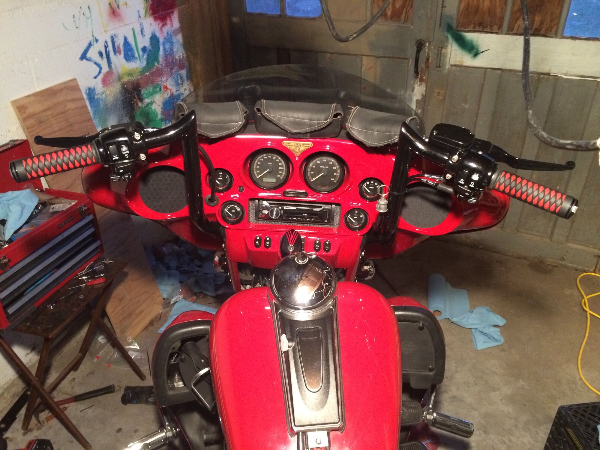

Only reason I’d go with the 12s is I think I may end up pulling the bars towards me for preferred hand position (feel like I’m reaching a bit) and the 12s would have offered more room to lever them. Downside would be likely changing both clutch and brake cable. No need with the 10s.

Notgrownup - Cool bike! Mine is exactly the same. 2007 FLHTC in Black Cherry Pearl. How much longer cables did you need for 12s?
gonemad - with the 10s did you have to extend cables?

P-Daddy, with mine I had add to the electrical for both sides. Not the TBW. Brake was fine. Clutch I rerouted underneath to gain some length.
for electrical Magnum Shielding offers a kit that makes the addition easy. Appropriate pin connectors are already on the extensions so just plug them in and seal with shrink tube. Colour coded and No soldering involved.

I think I did 4” over but it’s been 10 years. I bought the cables from Eastern Performance Cycle and they helped me out. I did the work myself. I want to put them on my 14 Tri Glide soon.

12" Monkee Bars on my 07 EGUC
