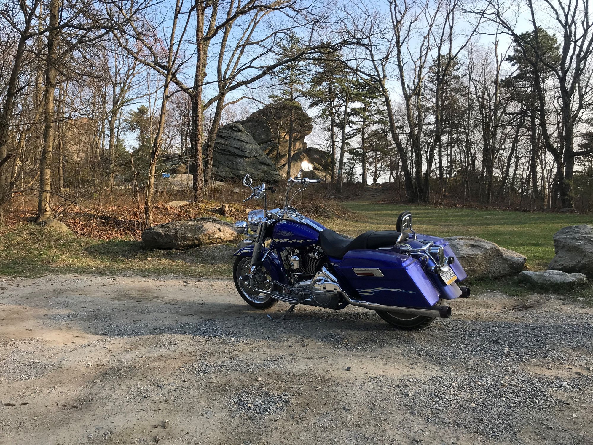

I'm hoping someone here can direct me to the hardware I need to mount a tour pack to my 2007 CVO Road King. I bought a tour pack at a swap meet that came off of a 2015 Street Glide (I'm told) and I plan to put it on my RK. I just need to find the bracket that is correct for my bike. If things don't line up with the tour pack itself I can build or modify to make that side of things work. Right now my bike has a low backrest that just snaps on/off and I'm hoping to attach the tour pack in the same manor.
Should also mention that I'm not trying to spend like a million dollars either. The tour pack won't get used much so Chinese amazon parts are my friend.
I added some pics of my bike if that helps determine what parts I need to track down. Thanks for any help.

1. Tour pak off a street glide should have g mounting bracket installed, all you should need is the 4 pt docking kit.

The bottom of the tour pack doesn't have anything attached to it. Just holes that it looks like I'll be able to bolt to. I had ordered a bracket on amazon which said it was for my model but it didn't fit when it arrived so I returned it. Can you direct me to a 4 pt docking kit that will definitely be the right one?

I acquired a tour pack that came off a '99 model year. All I needed was the tour pack mounting plate for the 4 point docking system. It was $200 at he dealer the plate mounted to the bottom of the tour pack perfectly no fabrication necessary. I am into the whole thing for around $500. Beats paying the $1200 the dealer wanted.

You need this piece:
https://www.ebay.com/itm/18314764873...EaAuslEALw_wcB

Take a picture of the docking points where your sissy bar is mounted so we can see if you have a 2 pt or 4 pt docking kit. The mounting plate under the tourpak is another part.
