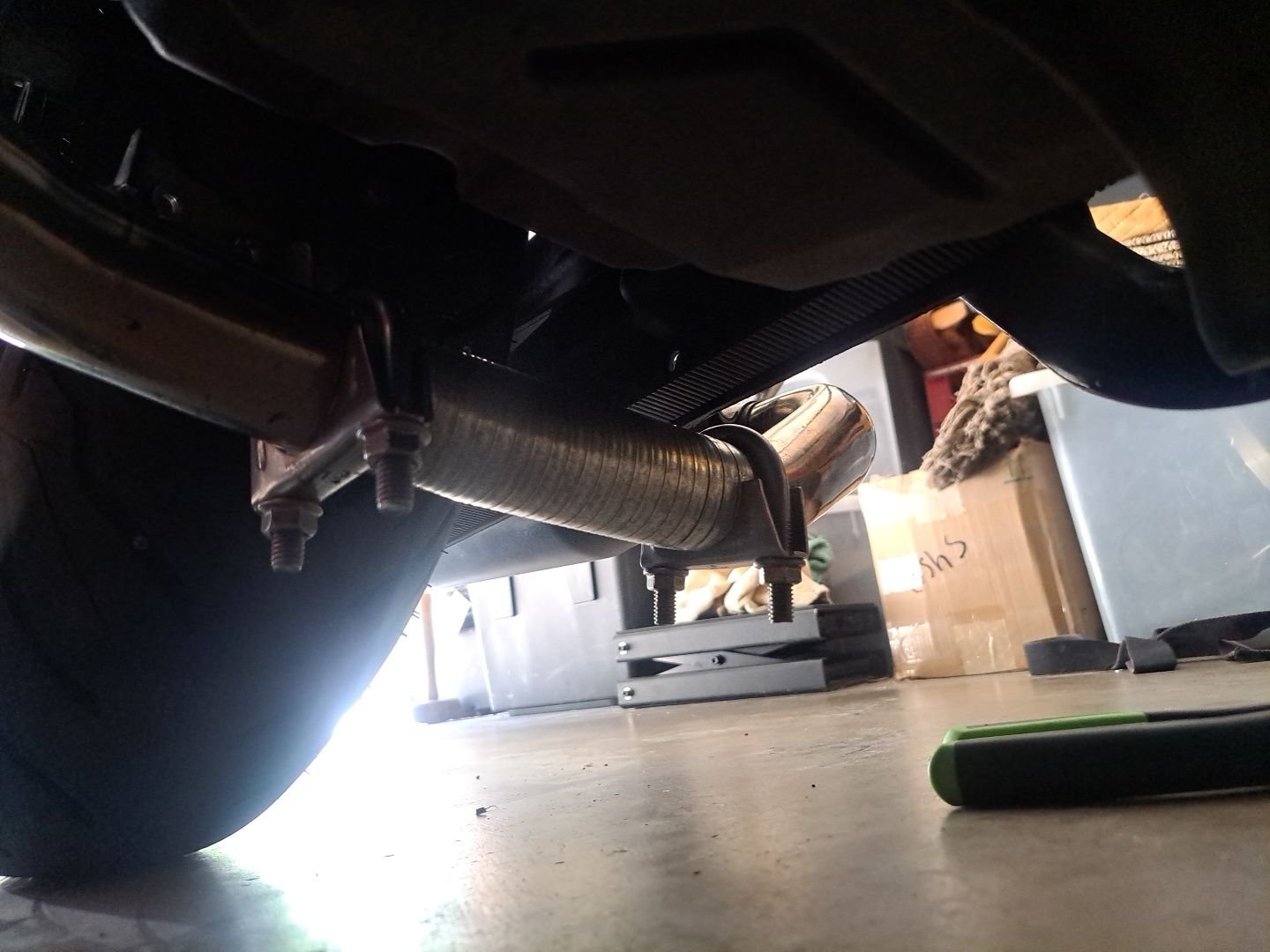

Traffic was busy and I hit and ran over a solid chunk of metal. Hit the front tire and it bounced up, then hit under the bike with a very loud metallic thud. I was worried it hit the engine, oil pan or transmission. Checked the information screen and it showed oil pressure good. Look back for leaking or smoking. Nothing. Got home a few minutes later. Looked at front rim, no damage. Looked under the bike at the engine and didn't see anything. A few days later I was putting air in back tire and looked underneath and what i saw was incredible. I had smashed the underneath cross over nearly flat.
This is the Cobra Pro Chamber. I called and Mike at Cobra was very helpful and said he could send me a replacement pipe. This was on Friday. Would ship out on Tuesday and take several days. In the mean time, I cut out the bad section and used a piece of exhaust flex pipe. It worked. Another buddy had made a cap to block off his stock exhaust on his 2025. He gave it to me to try. With a little modification I was able to get it to fit. The cuts to expand it did allow a very small amount of exhaust to leak out.
using exhaust flex tube

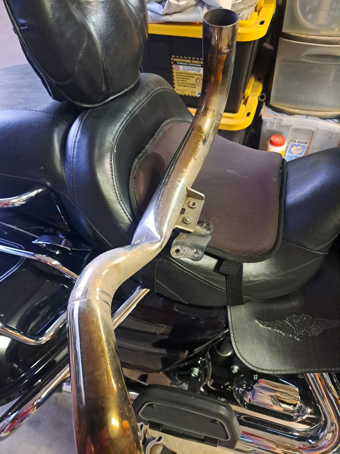

Here is the block off piece

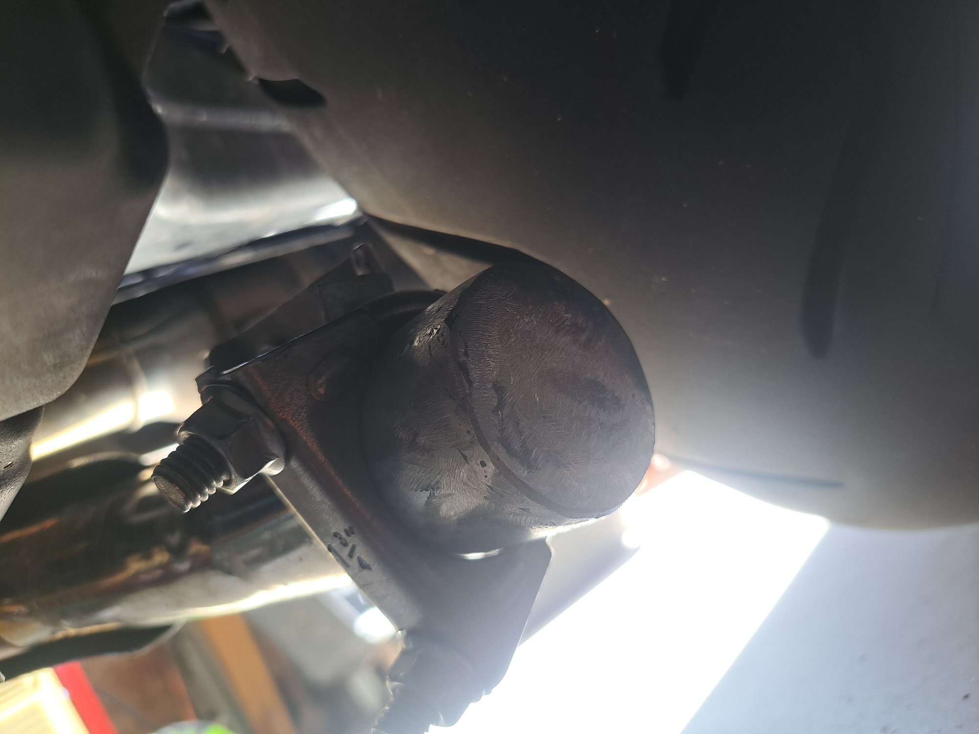

After the cross over chamber, blocked off the pipe
Went on another ride. Well, now I notice some difference. With the original setup, there was a stumble off the line up to 2000 rpm. With the pipe blocked off, there is NO stumble. Great acceleration.
Tomorrow I am going to my indy shop and have the bike put on the dyno just for a power run. I had a power run done 18 months ago so I can compare to that data sheet. I have received the new cross over. I will put the new cross over on , and go back for another power run and see the results. I might just leave this as a 2-1 set up.

It would seem your mod combination needed a little more back pressure...
Whoever tuned it before, should have been able to minimize, or get rid of that stumble....
A poor tune, will hold back a good exhaust.
A good tune can make a substandard exhaust do well.
You can't accurately compare different exhaust systems, without also doing a proper tune for each individual exhaust change....
