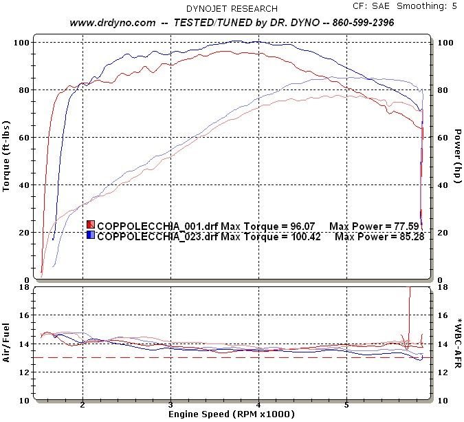

9% boost in HP. Stock '14 Ultra - added Arlen Ness Big Sucker A/C, Power Commander V and tuned
