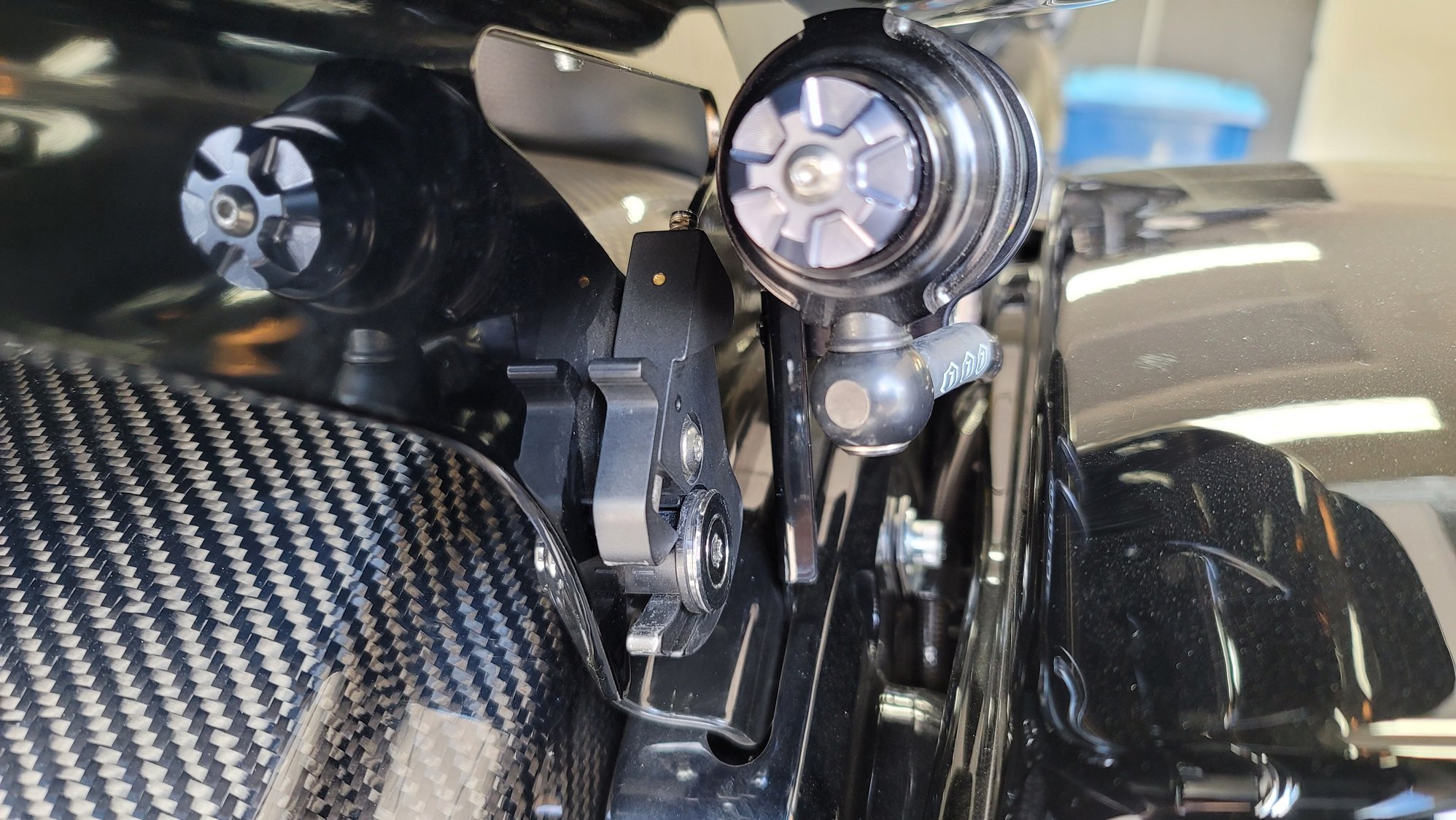

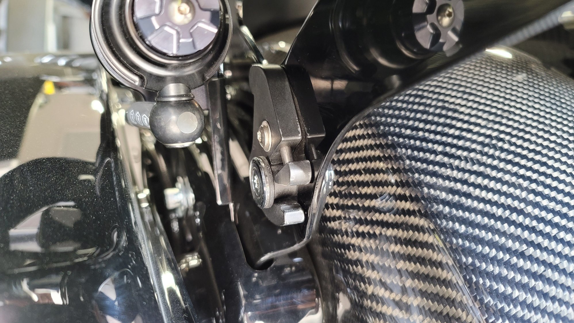

Originally Posted by vedavyasa@gmail.com
yes, i use one lock on luggage rack and one on sissy bar. I think I installed them incorrectly so instead of facing one way i faced them the other way. Next time will cut the key like you did and follow the installation instructions
No need to cut the key when installed correctly. Follow the installation instructions, and the key hole will face rearward. From your pics, it looks like you have the lock on the right side. From the instructions, it appears the recommended location for a sissy bar upright is on the left side.
yes, you are right. That’s the mistake I made on the sissy bar. I might think of new locks and do it right. Anyone have photos of it done right ?

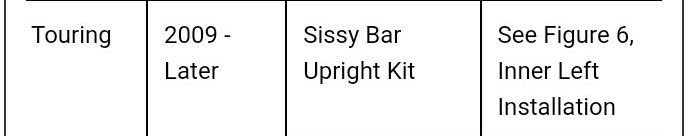

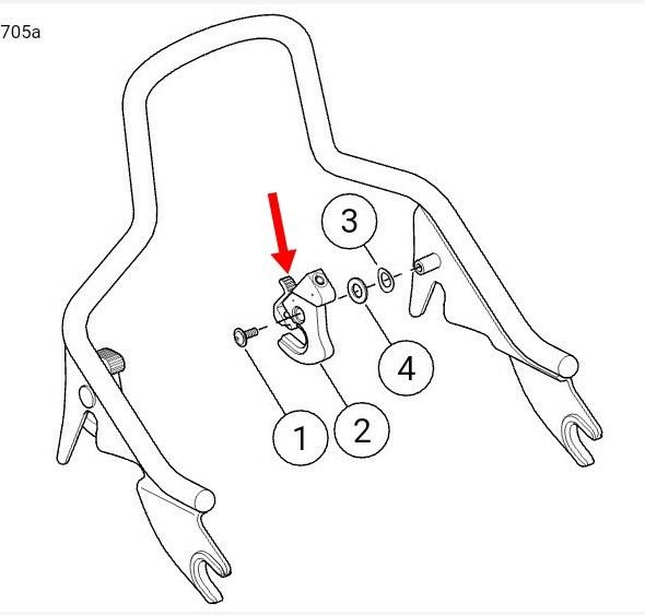

barneyboy's Avatar
barneyboy
Joined: Dec 2017
Posts: 5,077
Likes: 3,293
From: Plover, WI
The image from the instructions shows the correct orientation. Install on the left side of the sissy bar with the release button facing to the rear.
You have yours installed on the right side of the sissy bar with the release button facing to the front.

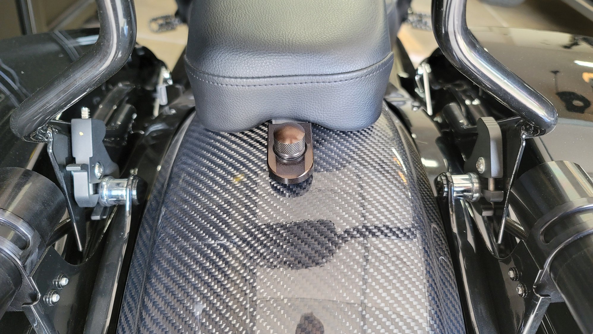

I personally love the lockable latches. No worries of anything walking off. I mainly got the lock for my tour pack for when I've got two high dollar full faces locked inside while out to dinner. Here are pics of the installed latches. Few from the tourpack and some of the sissy bar. Don't mind the remote reservoirs as they don't interfere with the oem docking or latches.
thanks.nice ! So if I follow instructions I should be good right ?
Looks like you just had them facing the wrong way.
