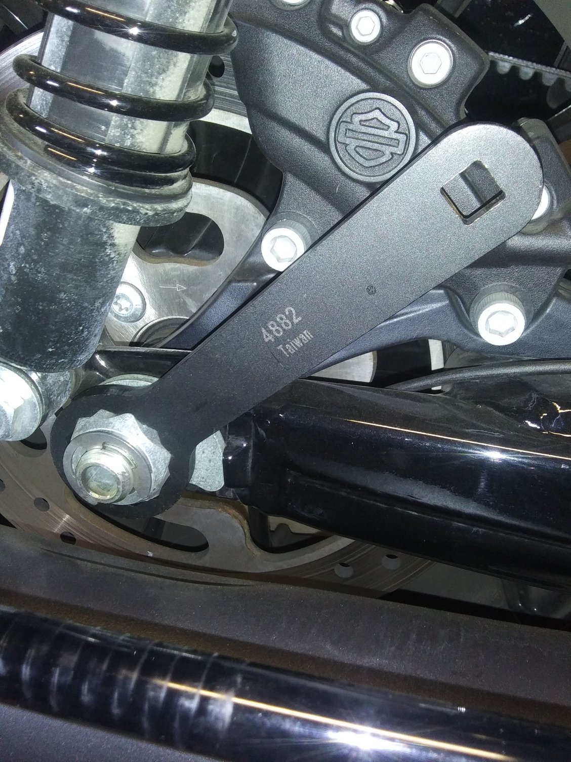

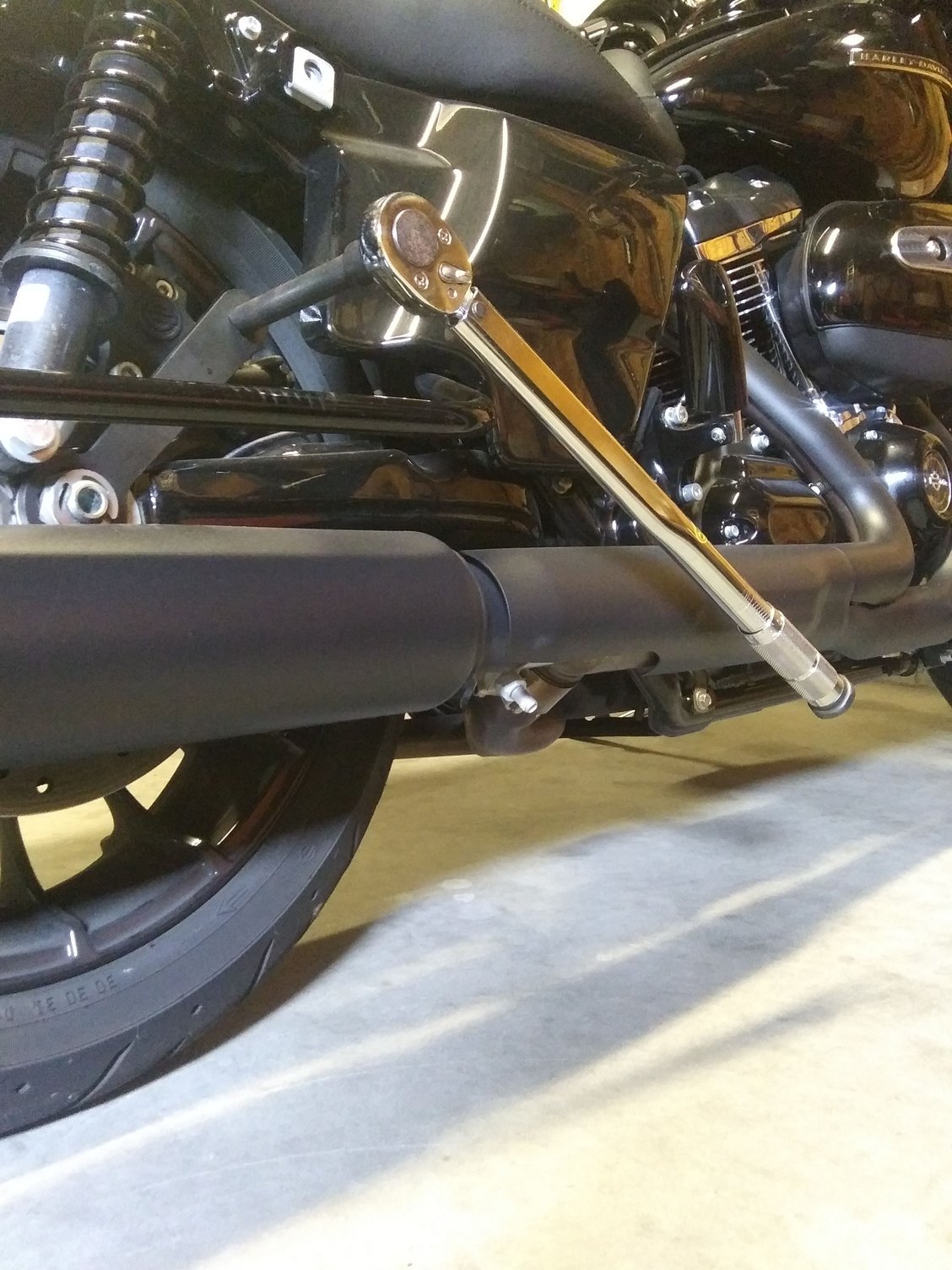

As previously stated, the JIMS 3rd hand tool will hold the weld nut, along with both cams absolutely stationary while applying torque to the cone nut.
This is the torque adapter I use.
Yeah, it's made in Taiwan, but it fits perfectly without slop or modifications, and has served me well. One thing to note, with the muffler in place, it's impossible to position the drive end below the muffler (6 o'clock). With the muffler in place it has a limited range of rotation (drive end between 1 & 2 o'clock).
A 6" extension provides the necessary clearance to work the wrench from a comfortable position.
FWIW, my bike is fitted with OE mufflers and shocks.
