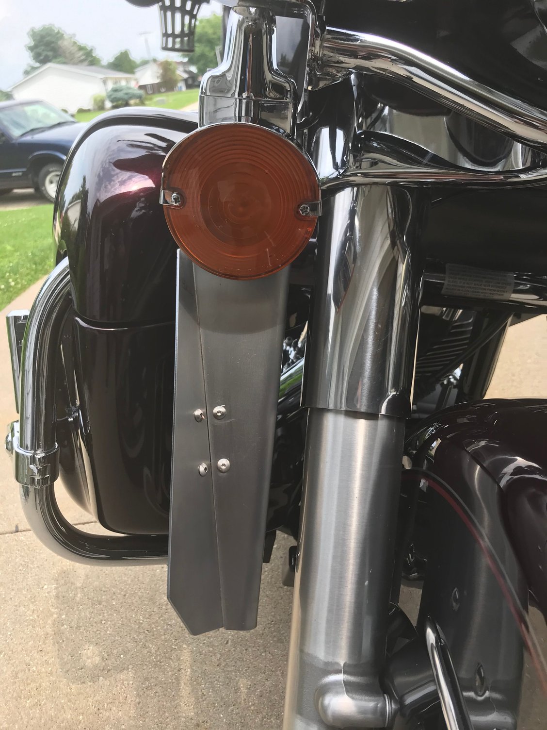

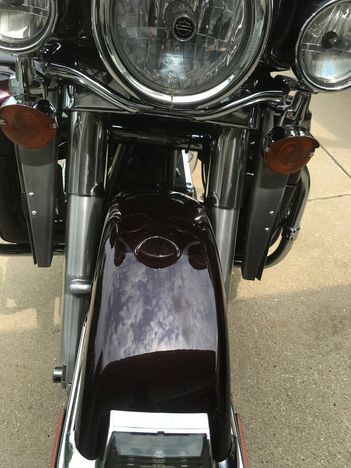

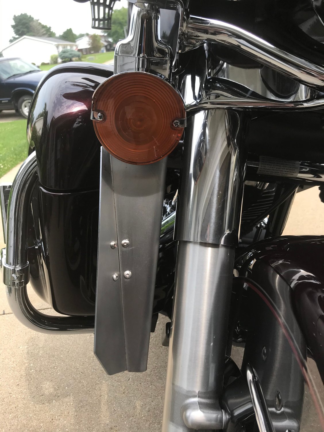

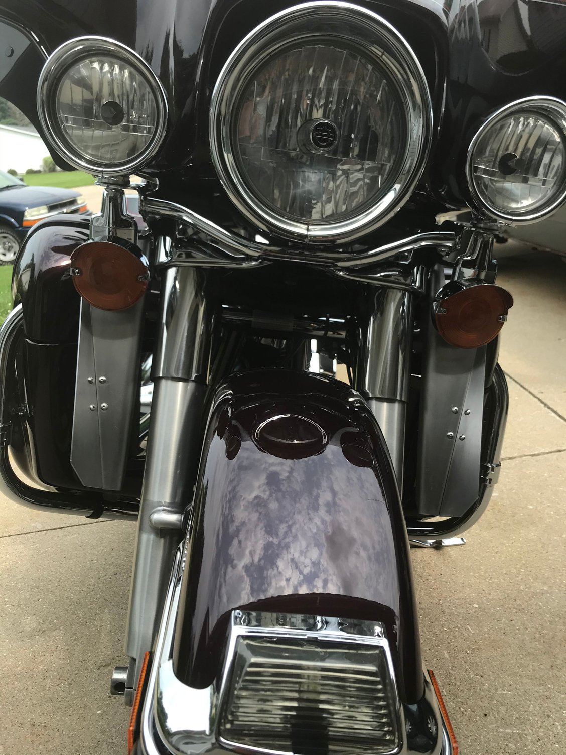

Got a set today in raw, Made them so they open up on the real hot days.
Just have to take off and paint now.
Closed
Open
Closed
Closed
Open
Open
