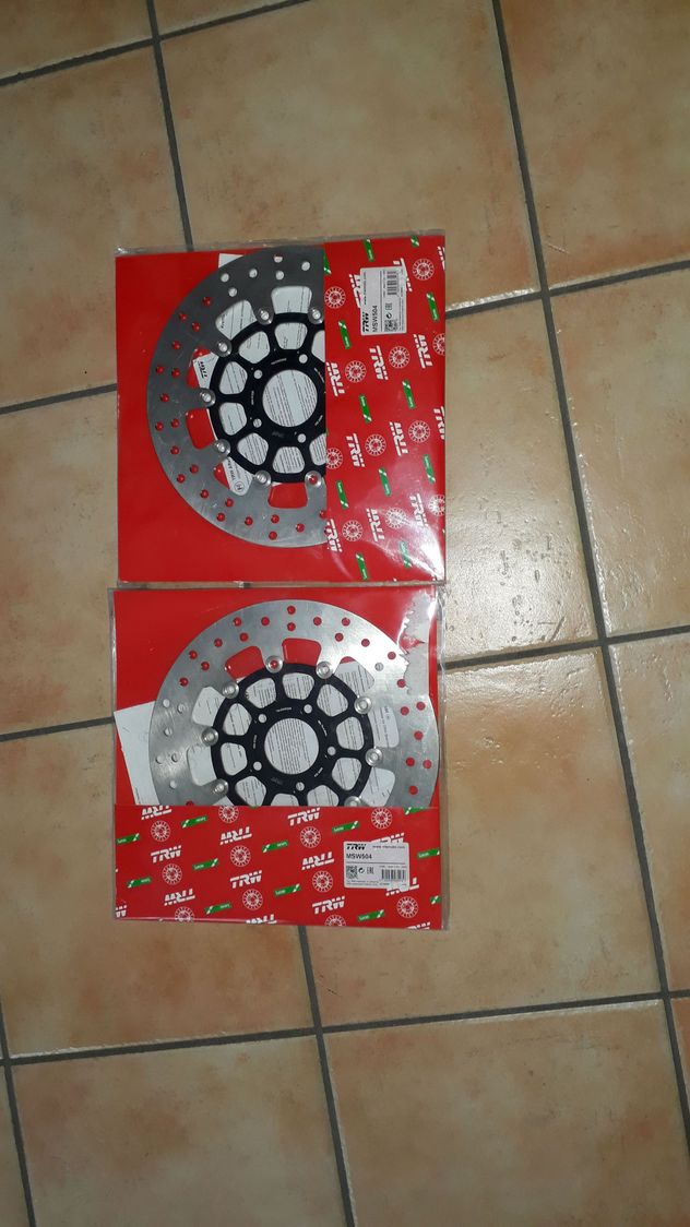

Last year I replaced the rotors. Front rotors are TRW model MSW504
Front rotors, perferctly fit my FLHT '09
Rear rotor is standard HD
