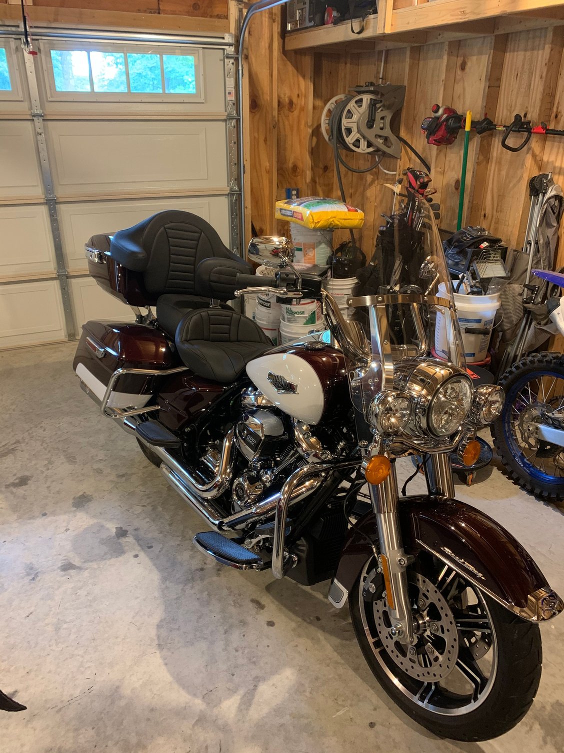

Originally Posted by rauchman
Congrats on a great bike. Post up some pics of your beauteous steed
Thanks!!!

Originally Posted by Pops4
Thanks!!!
Oh mama. You got "that" color. Beautiful bike! What seat is that?
