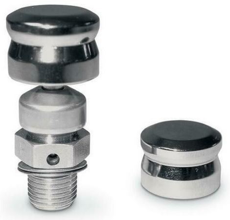

Timely thread for me.
I have recently been thinking about changing my black caps to chrome caps.
I found these from Drag Specialties:

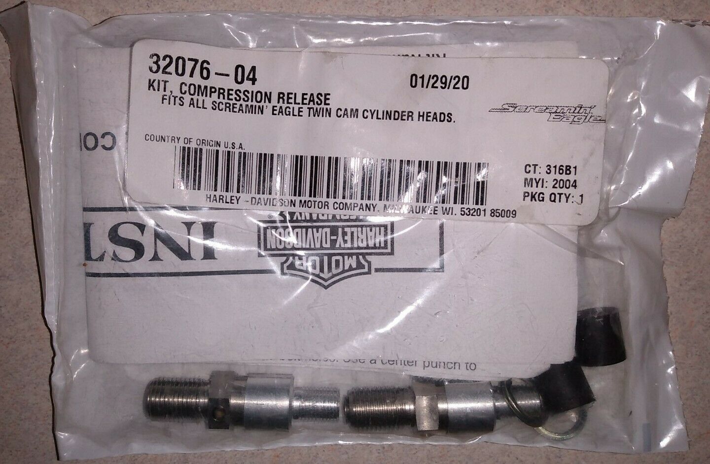

Old Aug 26, 2021 | 08:45 PM
Ed Ramberger's Avatar
Ed Ramberger
Joined: May 2015
Posts: 3,585
Likes: 1,214
From: Then Wisconsin, now North Carolina
The pic of yours is not the one in the bag. It looks like it had the blue plastic tops or the aftermarket metal ones as pictured above.
Gentleman. Thank you for your input, FYI, I was also even told to look at drawer pulls. I don't know if anyone will need this information since Harley does not offer manual compression releases anymore, but after reaching out to Dennis Kirk, Amazon and eBay, another fellow enthusiast told me that old school mechanics are the best parts finders. Turns out TP Engineering supplied manual compression releases to Harley. I have spoken to TP Engineering and they will have the cap I need in stock in about a week. If I need to use the MCR before receiving the new cap from TP Eng, I have a 6-32 acorn nut I can use. OBTW theheder, the drag specialties chrome caps silicone down onto the black rubber caps, if you want to talk to Dennis Kirk like I did, they have an array of caps that thread down onto the shrader threaded caps in lieu of the black cap. Or you could also reach out to TP Engineering to see if their billet or brass cap will replace the black caps you have.
