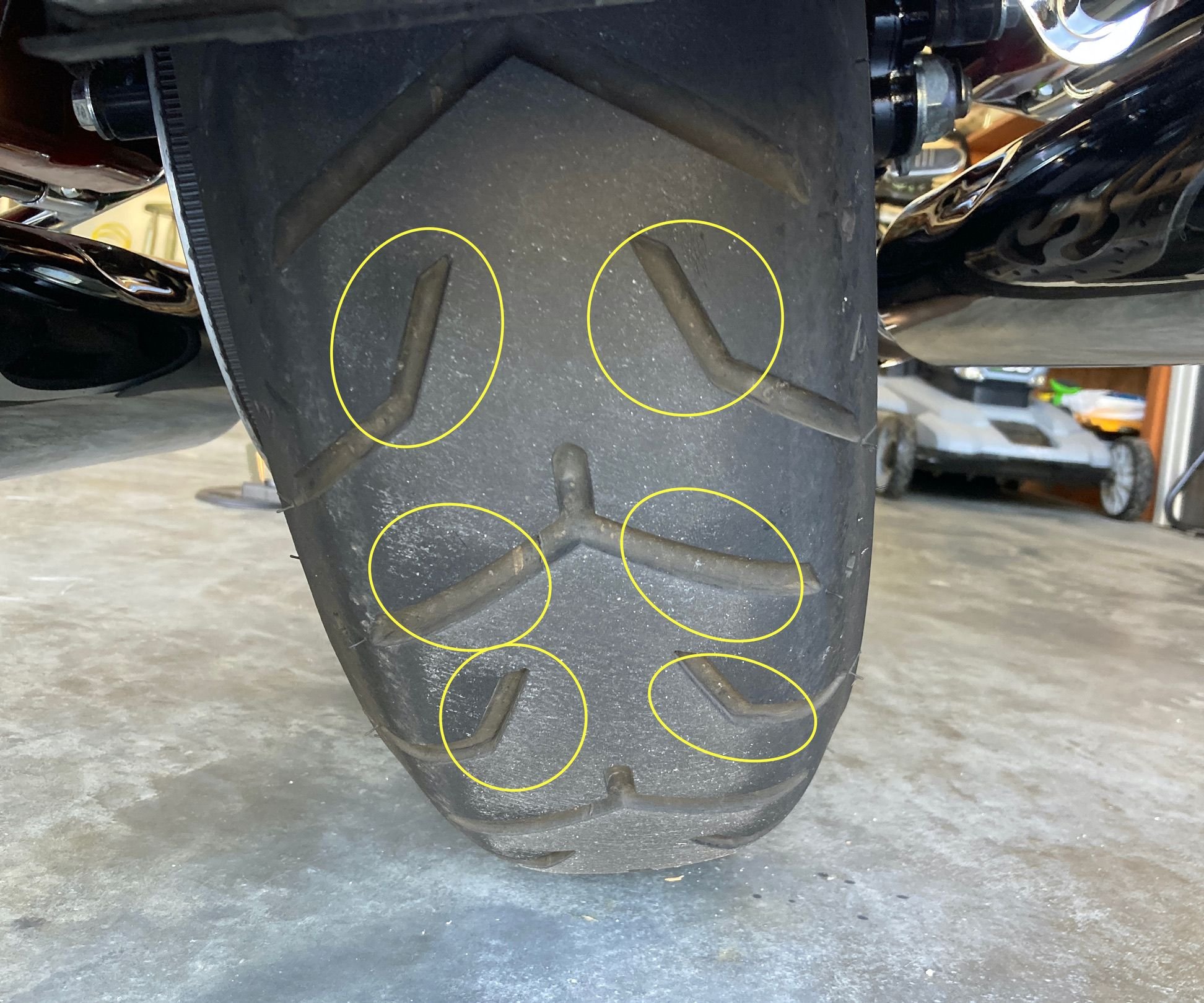

gonemad's Avatar
gonemad
Joined: Sep 2020
Posts: 8,113
Likes: 9,504
From: central NC
Looks like this
Old Sep 17, 2021 | 07:06 AM
NELS's Avatar
NELS
Joined: Jun 2008
Posts: 1,343
Likes: 173
From: Watertown, CT
Originally Posted by Jeffk48867
Even though its just cornering to left?
In CT, the roads are banked casing more wear on the left side causing the howling.
When doing front end alignment on cars that is taken into consideration to avoid pulling to one side.
Yup, Its the tire.
