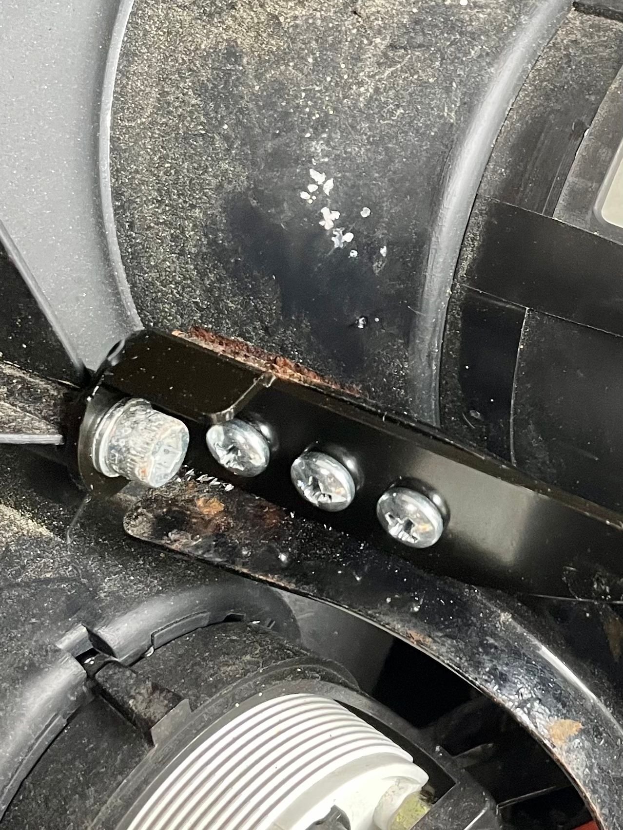

Got the brackets repaired using these things.
Rectifier/regulator will arrive tomorrow. Hope to ride on Sunday!
