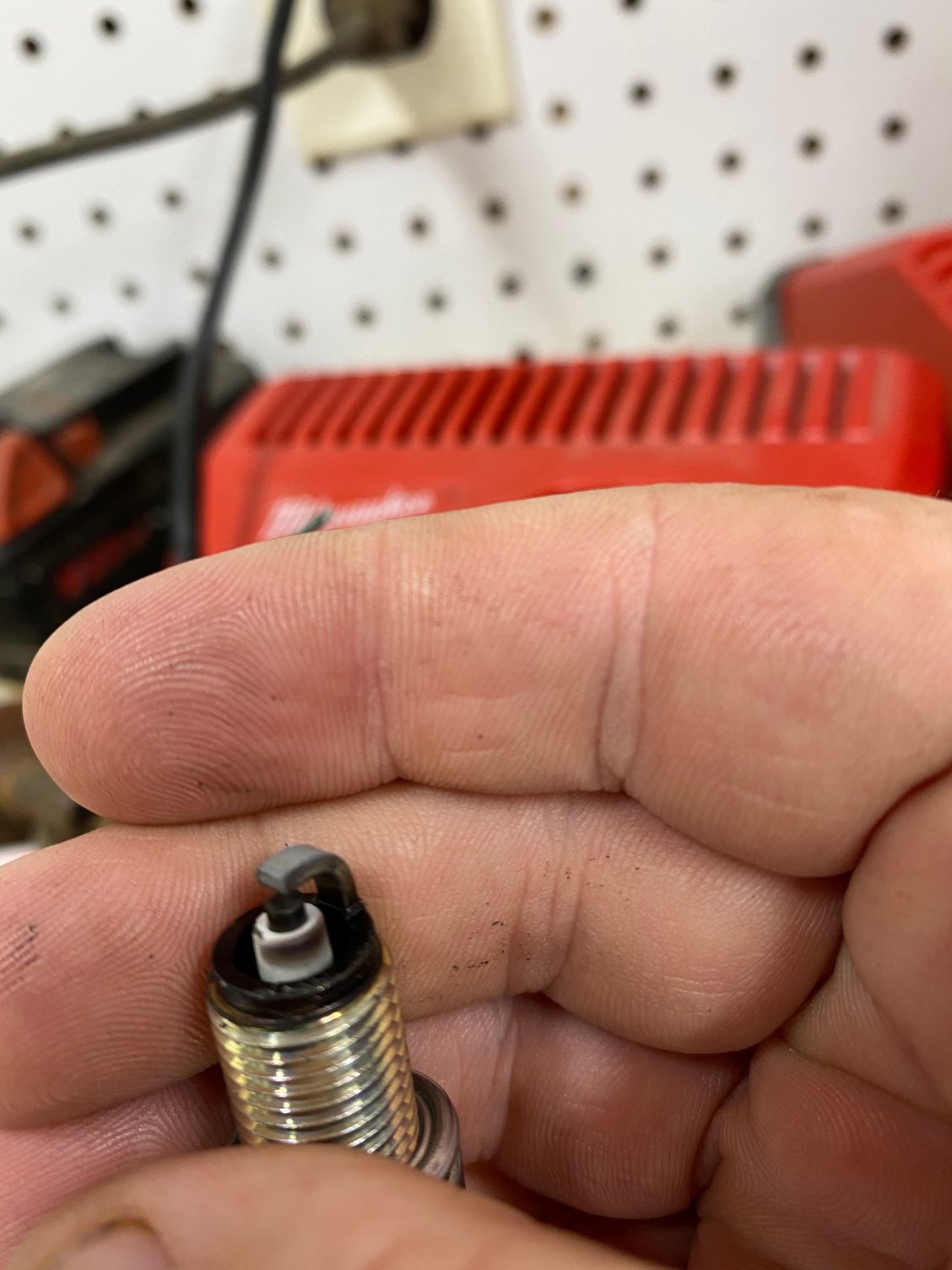

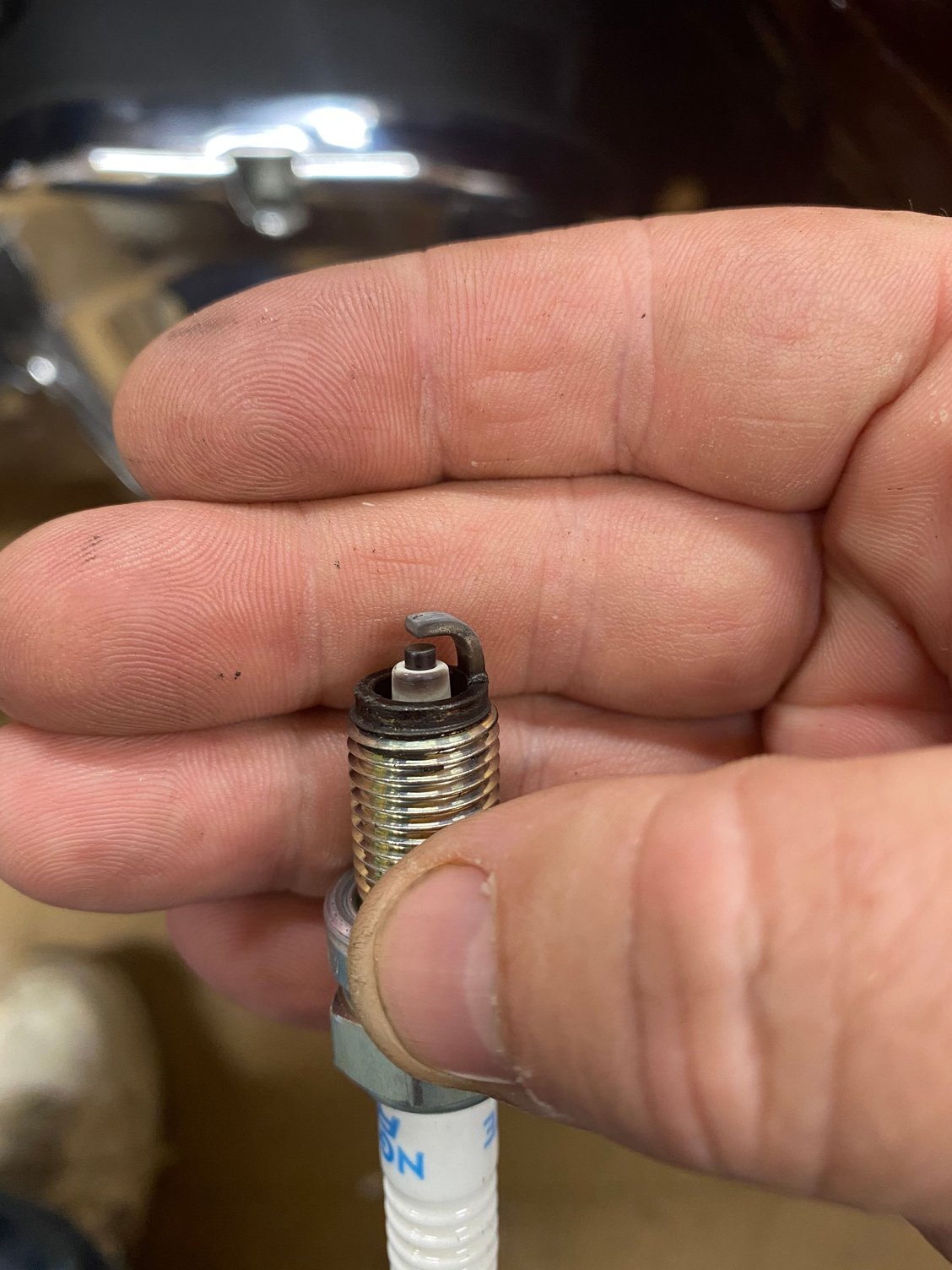

Did the 3 hole oil change and plugs last night and took her out for a 70 mile short ride. What a difference some oil and plugs make! She still misses every now and then but nothing like it was doing. As for the engine light it still comes on at random moments local shop said they would do a diagnostic for $89 but haven’t decided if it is that important at the moment. After 15 years without a bike I am really enjoying this. Pulled the plugs when I got home just to see if it was still running rich or lean but I don’t think 70 miles was quite enough
