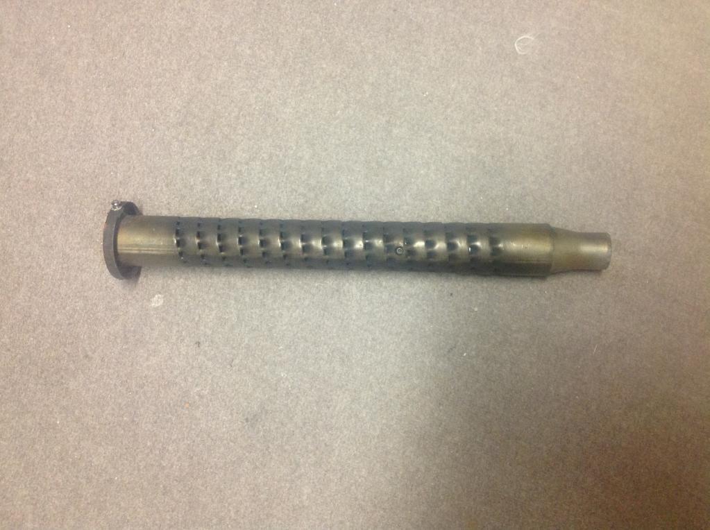

I would like to wrap my baffles of my RCX HAUST what is the best product to use and how to fasten it?

You can more than likely purchase baffle wrap from your dealer or indy , the sheets come in various sizes , my recommendation , is to buy a more dense wrapping and wrap the baffle as tight as you can and roll it on using a couple layers or until the wrap is on the outer edge of the baffle , then use packing tape , I've even used tuck tape to hold it in place . The tape will burn off , much like the saran wrap they use on factory pipes .
Some use bailing wire as well , but not for me , I find it heats up and burns the wrap , leaving you with peaces of wrapping . Also if the wire is up against the exhaust / slip on , it can leave a discoloration on the chrome .

I wrapped baffle with stainless steel wool and secured with light "tag" wire. Not sure how much difference it really made, but seemed to take a little of the harshness/bark out of it. Special baffle wrap would probably work better but I didn't have much clearance to work with.
