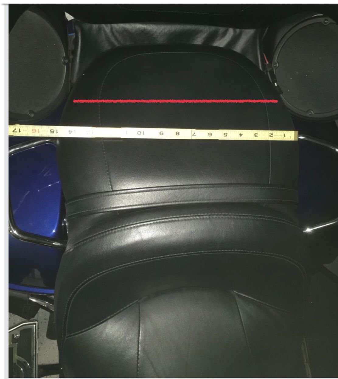

Could someone with a 2014 or newer Ultra Classic or Ltd please measure the width of their stock seat at the widest point across the passenger section. I am looking at purchasing a takeoff seat from a newer Ltd to replace a worn out torn seat on an earlier 2012 model. I know the seats changed profile slightly with the introduction of the Rushmore bikes and while the newer seat will fit my frame I want to be sure that it will fit ok between the speaker pods on the tourpak as that changed also. Thanks in advance.

This what you want? ‘17 Ultra Limited

Perfect! Thanks
That's about 15in at widest point and maybe 13in where the seat meets the speakers

The seat tapers towards the rear. Where it’s at about the middle of the speakers, per the red line, it’s 14”.

Thanks TG....I should be good. The older seats prior to 2014 are actually wider at about 16in across and I think the speakers are spaced a bit further apart on the older tourpaks also.
