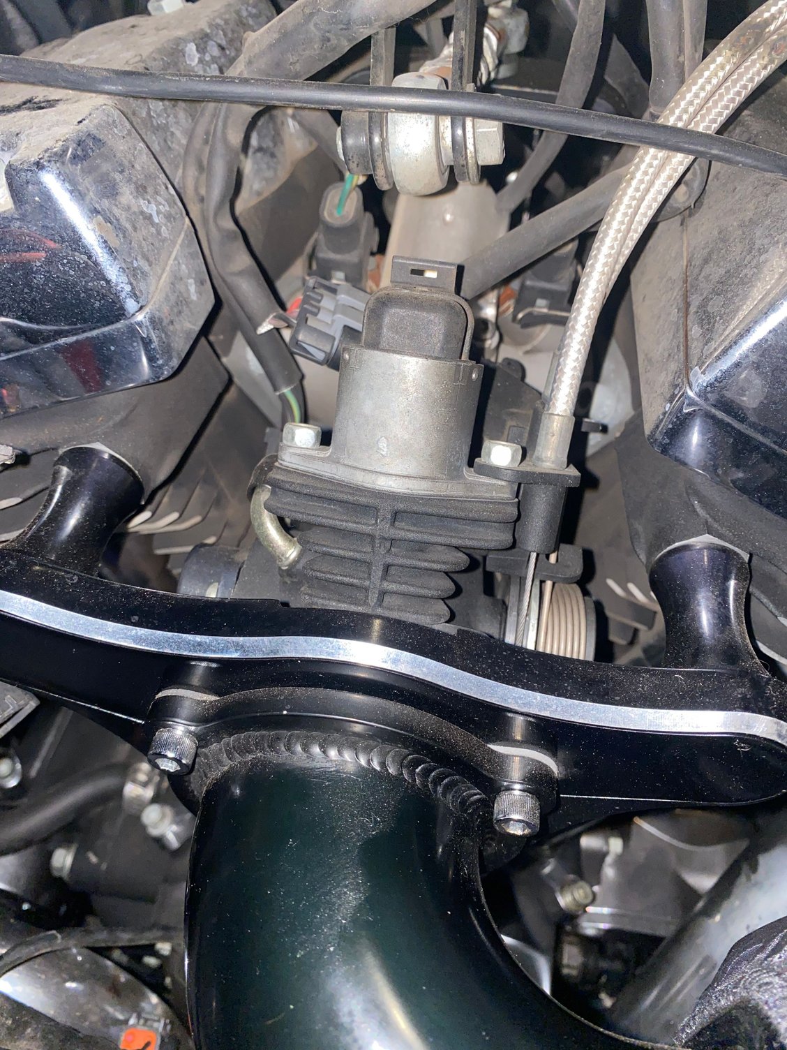

That HPI says its for 06-17, so guess it won't work on my 03. I'm still trying to figure out just what I have on mine. I haven't disassembled it yet, but how do I tell what my Throttle Body is? Size? Where do I measure it? Is it the opening size where you put on the intake/air cleaner?
It will work on the S&S crate. That is what you said you
were dropping in it.
You mentioned you blew up a ultima motor.
was it the complete ultima twincam engine.
Take some pictures of the throttle body

no it was a Screaming Eagle 103. I have an Ultima transmission. It’s fine. Here’s a quick pic. I’ll have to disassemble if you need to see the whole thing.
