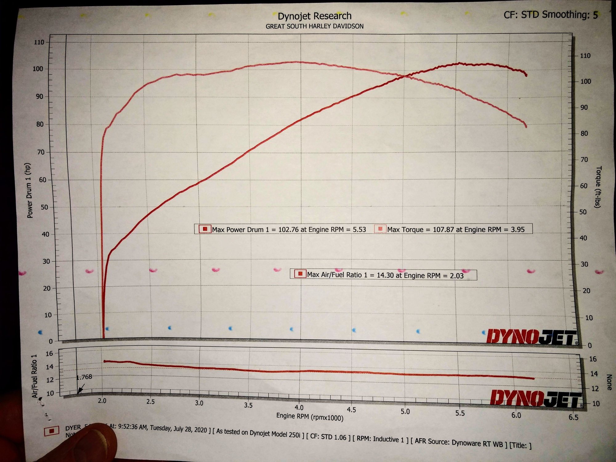

Hi, I have a 2009 96 ci Flhtcu. I went with the S&S 106 Hot set. The heads are still stock. I would consider this as a mild upgrade. The power and torque won't rip apart my clutch and my bike seems to be able to keep up with the new "Stock" M8's. 103/108 pwr and torque. Not monster numbers but if you have the heads reworked and a larger throttle body and injectors, you could get to 110 or higher.
I have a few thousand miles on the bike now and I'm very happy with it. Oh, one word of advice if you do the up grade, take it easy when letting out the clutch or you may accidentally do a burnout.🤪
What ever you decide, good luck and be safe.

S&S Hot set with out heads
