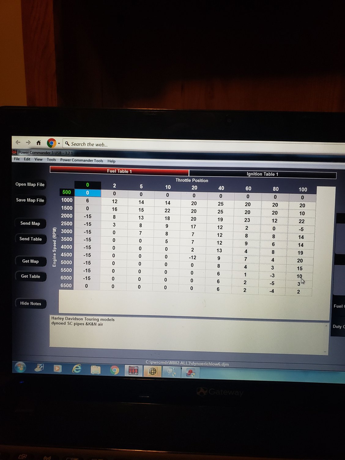

I'll see if I can find my old map from when I had the tw21 SE mufflers and K &N filter in opened up box
That would be amazing! Thanks for looking!
