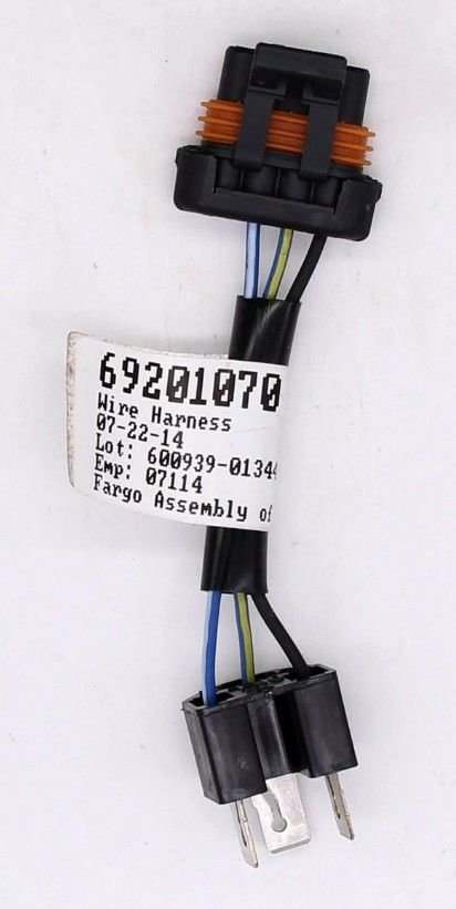

This is what you need, it's made by HD for the HD Daymakers.
I believe you'll also need an adapter ring to fit a Daymaker on your bike.

That's the one! (69201070) Local dealer had one. Going to pick it up after work. Emailed Custom Dynamics and they said they didn't carry anything for that set up surprisingly. Tried Namz also and no go. Also found out I need a different headlight bucket as well. The daymaker protrudes much more out the back of the bulb and wouldn't fit. Local HD shop had that in stock as well pt# 67700439. Thanks for the direction fellas and have a great day! Mike D.

Would someone be able to tell me what kind of Delphi connector the top one is exactly? I am not sure for it to be either a "150 Metri-Pack sealed connector" or a "GT 150 sealed connector". Neither one looks spot on...
Thank you, niv
