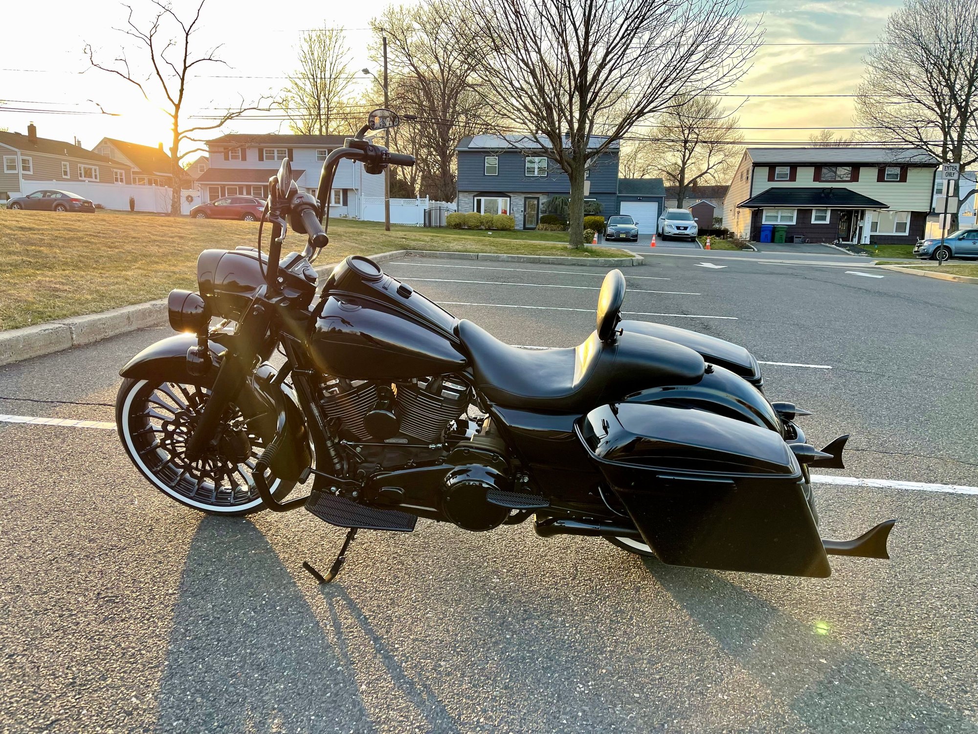

These are 36" for a visual reference. My experience with fishtails started with me running Bassani true duals and Samson cholo fishtails (with baffle) on a 2017 M8 RKS. After upgrading the cam to the S&S 465 I noticed that the fishtails with the true duals resulted in loss of low end torque. Now Im run the Fuel Moto headers with straight pipe eBay fishtails (inexpensive ones, straight pipe) and it sounds insane and gives me the Vicla look. Kept my FM slip-ons in case I ever decide to go back to normal.
Thats a good looking scoot. What length are the slip on's? And you recommend me staying with the stock head pipe?

Denis1227: I think staying with the stock pipe over true duals is a good idea. With M8s and fishtails there's most likely gonna be some loss of torque. My experience was that true dual headers only made it worse. My Fuel Moto pipe (like the stock headers) is more constrictive regarding air flow which my 107 seems to do better with than with the true duals. In the end its best to get your set-up (whatever you go with) dyno-tuned to ensure best air/fuel ratios and overall performance. Best of luck on your build Bro!
