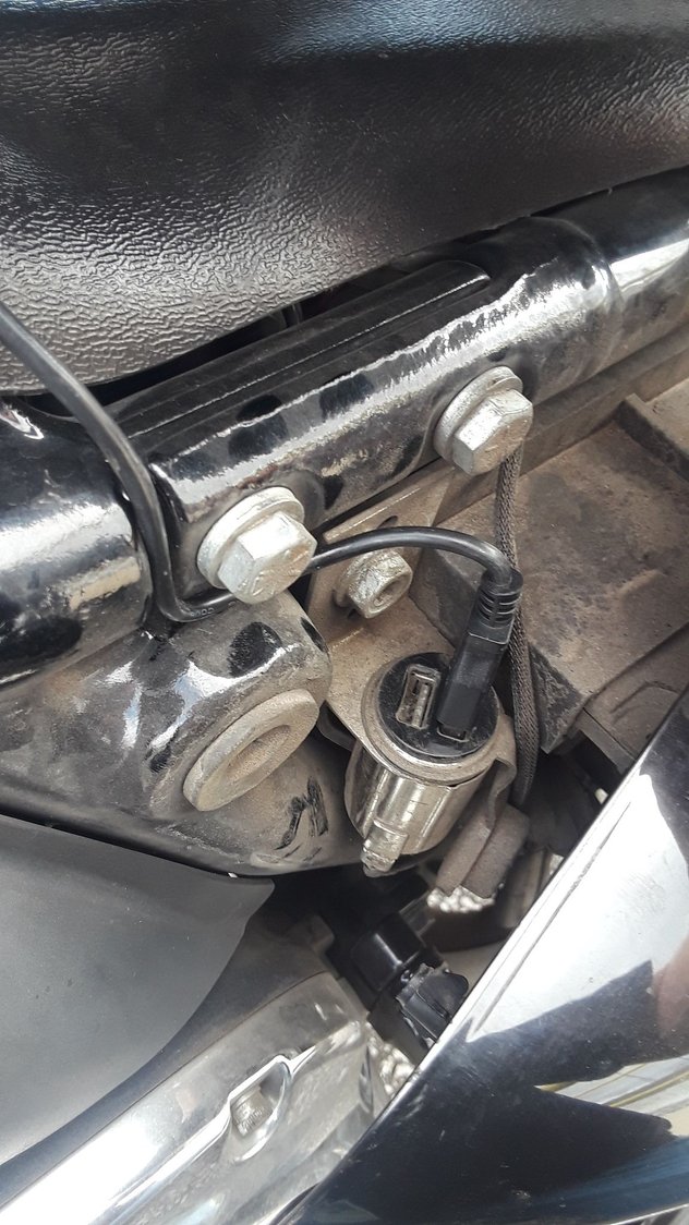

Originally Posted by Wide06
I don't have a picture handy of my actual, but here's a Paint of what I did.
The 12V socket is mounted to the bolt above it, as drawn here. USB adapter plugs into the 12V socket, and the USB cable is drawn blue and curves around as shown, and then through the frame joint slot behind the top of the side cover.
That's how my 2010 is set up. Here's my '18, basically the same way:
