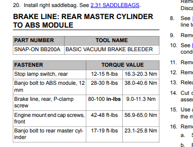

Hey guys putting in new braided brake lines on my 2015 ultra limited and just want to confirm the torque spec for banjo bolt to abs module. My Manuel says 14-18 ft pounds. That seems low to me so thought maybe I was reading wrong. Figure I’ll ask and see what the great minds here say.

Those bolts are hollow, so prob the reason for the torque spec. If you have no leaks after installation, then you are off to the races.

I think it depends on which Banjo bolt. Master Cyl to ABS or Caliper to ABS.

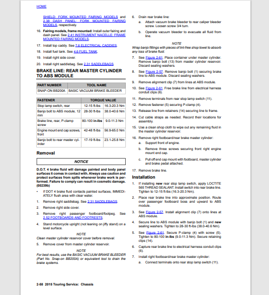

ok see this is why i ask questions first so looking at that I’m doing master cylinder to abs And I need to be at 28-30 ft pound correct ?

That is what I read too, the 12mm bolt 28-30 the 10mm from rear caliper 17-19.
