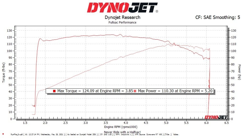

HD torque cam, 43 mpg.
That's an impressive dyno run and 43mpg is great. What is the exhaust system used on that run?

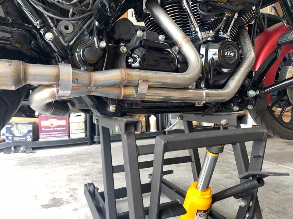

I have the Fullsac headpipe, S&S MK45's with Fullsac custom baffles, SE wedge air cleaner, SE 55mm intake manifold, SE Torque cam - tuned by Fullsac with a TTS tuner. There's no doubt that a different cam would provide more, but this is plenty for me and I still get pretty good gas mileage.
Here's the headpipe - very high quality. I installed it nearly a year ago and haven't had any issues with it. BTW, the factory heat shields fit on it perfectly.
