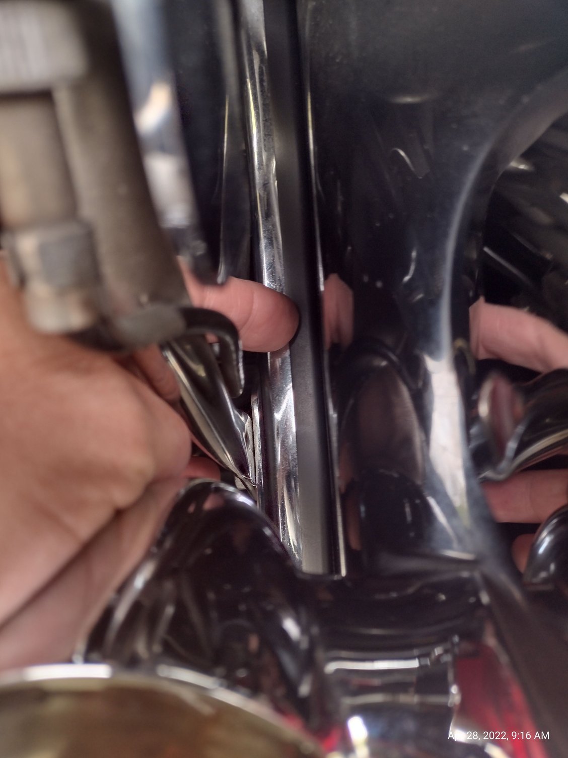

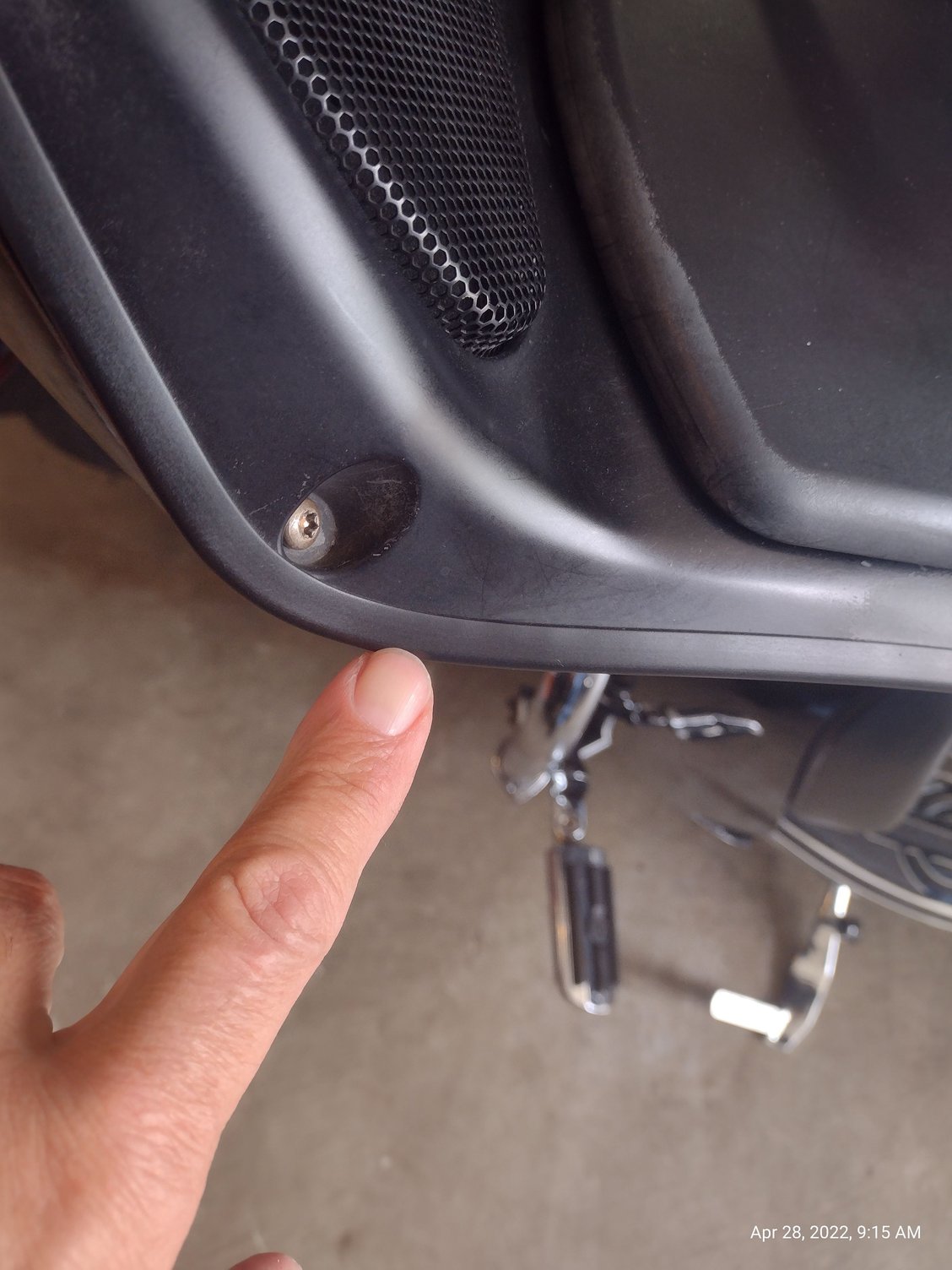

Frustrated with the H-D factory trim between the inner and outer fairings of my 2007 Road Glide I purchased Cowles Custom Truck/SUV Edge Trim from Auto Zone ($12.99 for 8 feet) and installed it. This trim is wider than the stock trim and has stayed in place vs the stock pulling out especially near the windscreen. Not to forget the factory trim glue oozed out on my lower fairings. I also installed this trim between my rear fender and the braces to either side. I used a plastic putty knife between the fender and the trim to make sure it is firmly around the braces. I tried the carbon fiber looking car trim ($19.99) which is narrower without success (it curled up and pealed).

Trim on the right side of the fender along the brace. 11-1/2" if I remember correctly.
Trim along the left side and the brace.
