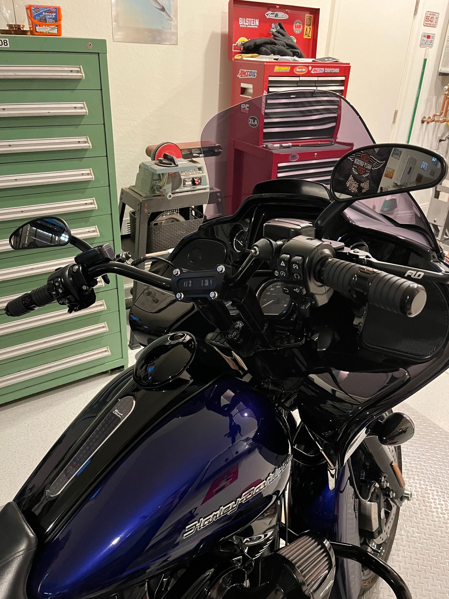

To better explain my throttle is very sensitive. No lag which makes the throttle very touchy. Looking to just mellow it out a little bit. Here's a pic of my bars.

Reach out to PV and ask them about the throttle response settings , I have never used the PV , but have with the FP3 . Their are settings you can change to make your throttle not so touchy .
https://dynojet.zendesk.com/hc/en-us...-by-wire-bike-
Hopefully , this will help , Good luck .
