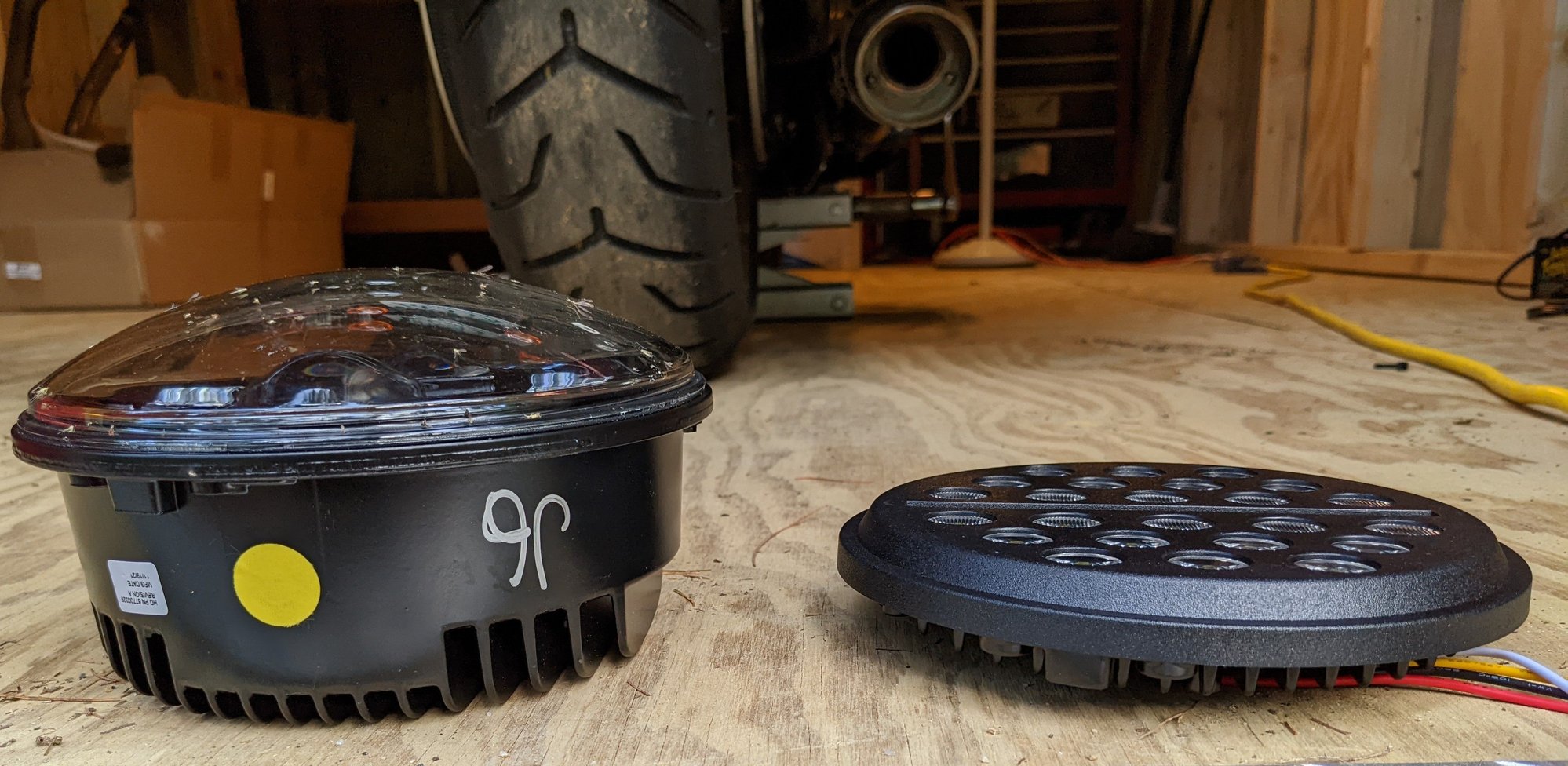

I have tried a number of more common and cheap amazon/ebay headlights in other bikes with different levels of results and wanted to try something different for my new bike. I went with a Moons MC 7" Moonmaker Flyeye LED this time around because I really liked the look (although some will hate it) and have also been happy both with the light output performance and the weight reduction and thought I would share with all of you. This install is dead simple and the same as any other headlight despite the size difference and for '14 and up you will need the harness adapter and I did NOT use the optional trim ring braket and everything mounted flat, flush, and secure without it. The manufacturer website has more pictures, but I also thought I would share the size difference and a shot on my new work in progress ('22 SGST) in hopes that this helps one of you in your decision of headlight upgrade.
