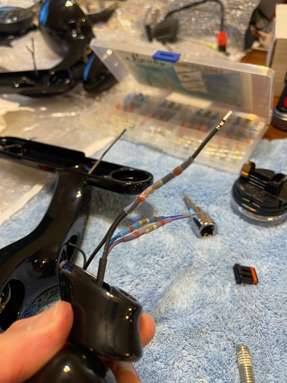

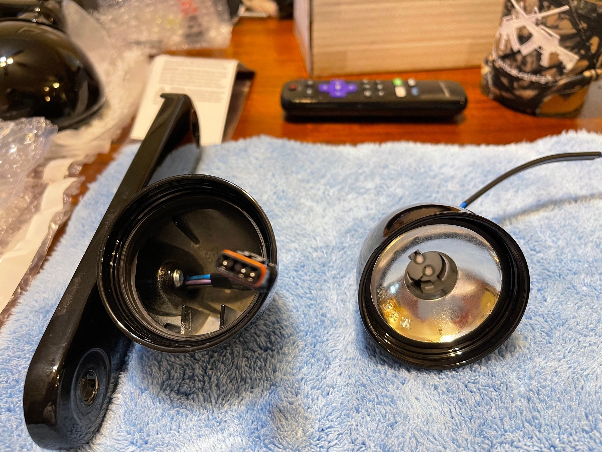

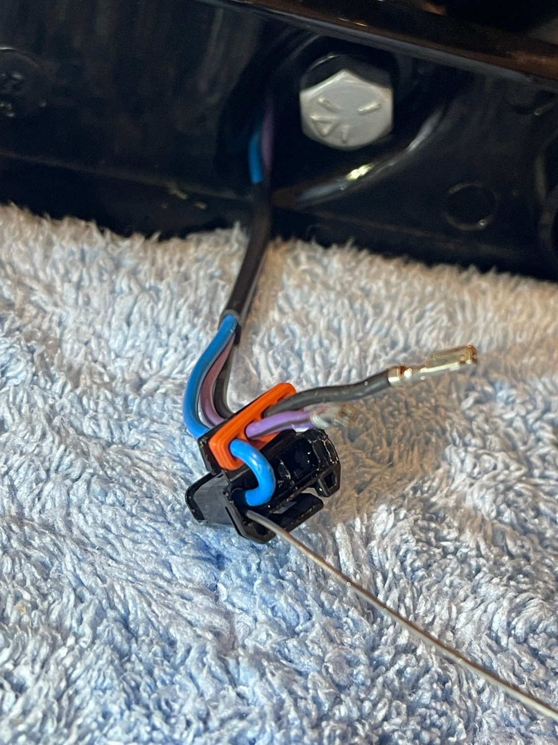

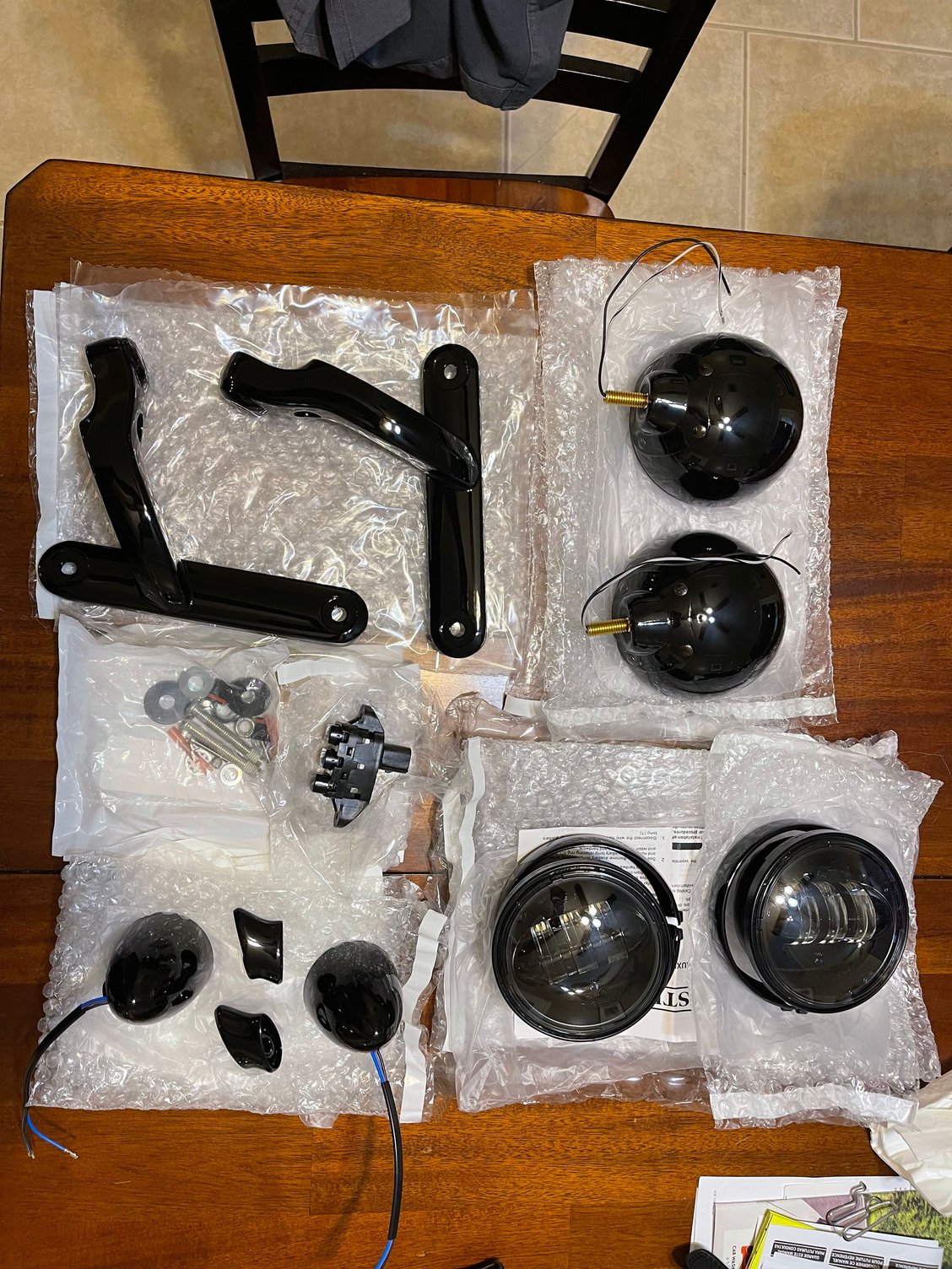

Had some fun in the garage today!! All my parts finally showed up. Installed Fat Baggers 12" 1 1/2" pointed top bars, some HD passing lamps and a Roger's Unlimited garage door opener. Install for everything was pretty strait forward. My only issue was the wiring for the passing lamps. My CVO has LED blinkers and the HD passing lamp kit comes with turn indicators that use regular light bulbs. I was able to de-pin the OEM wiring, but they were too short and had to splice the wires to make them a bit longer. There was plenty of room for the wires in the pass lamp brackets too. The bars came with longer wires, a clutch cable extension and the stock brake line was plenty long enough for 12" bars. Hoping to take it out tomorrow and see how the the new bars feel.
HD passing lamp kit

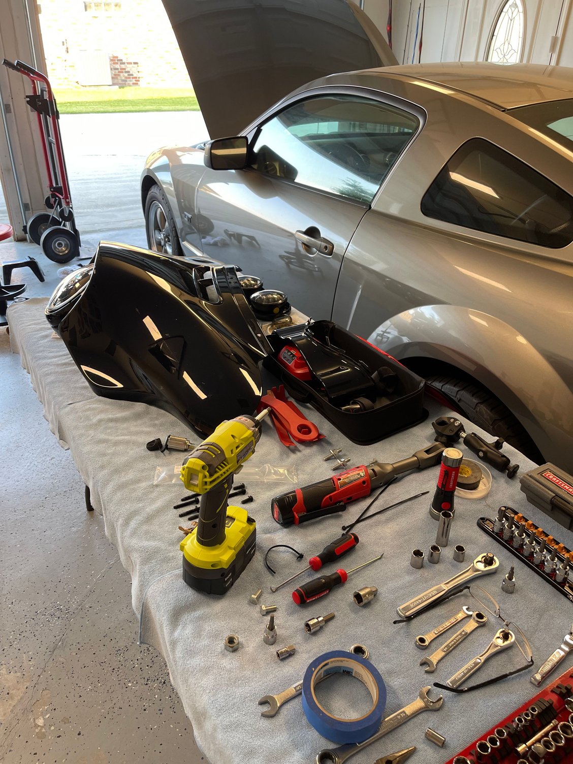

Getting set up for the madness
LED turn indicator on the left
Took a while to figure out the de-pinning
Spliced the wire with solder and heat shrink

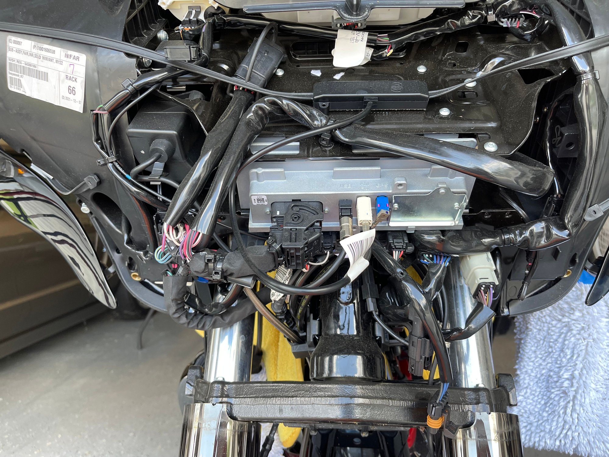

There's a lot of stuff under that fairing

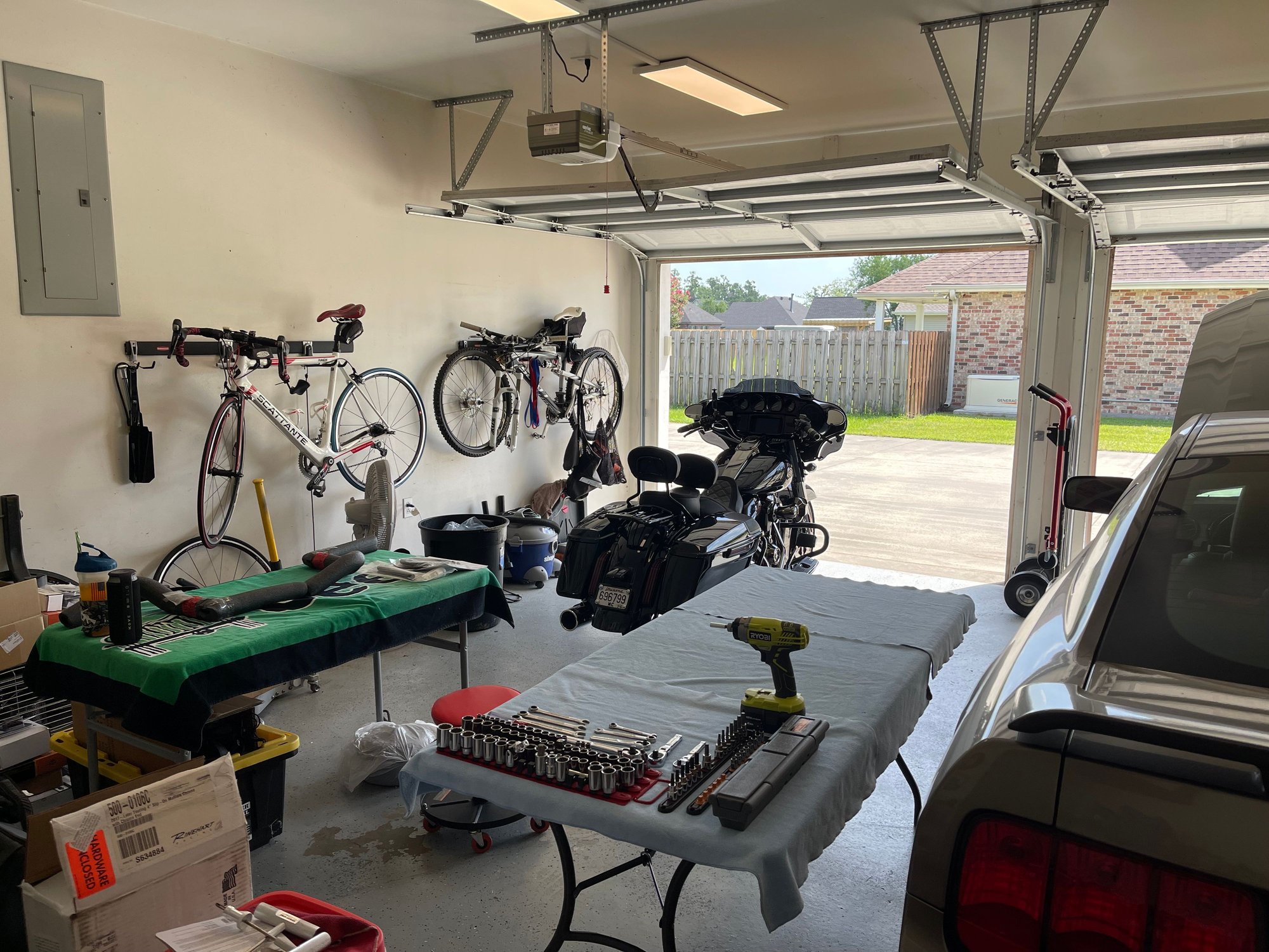

Trying to stay organized

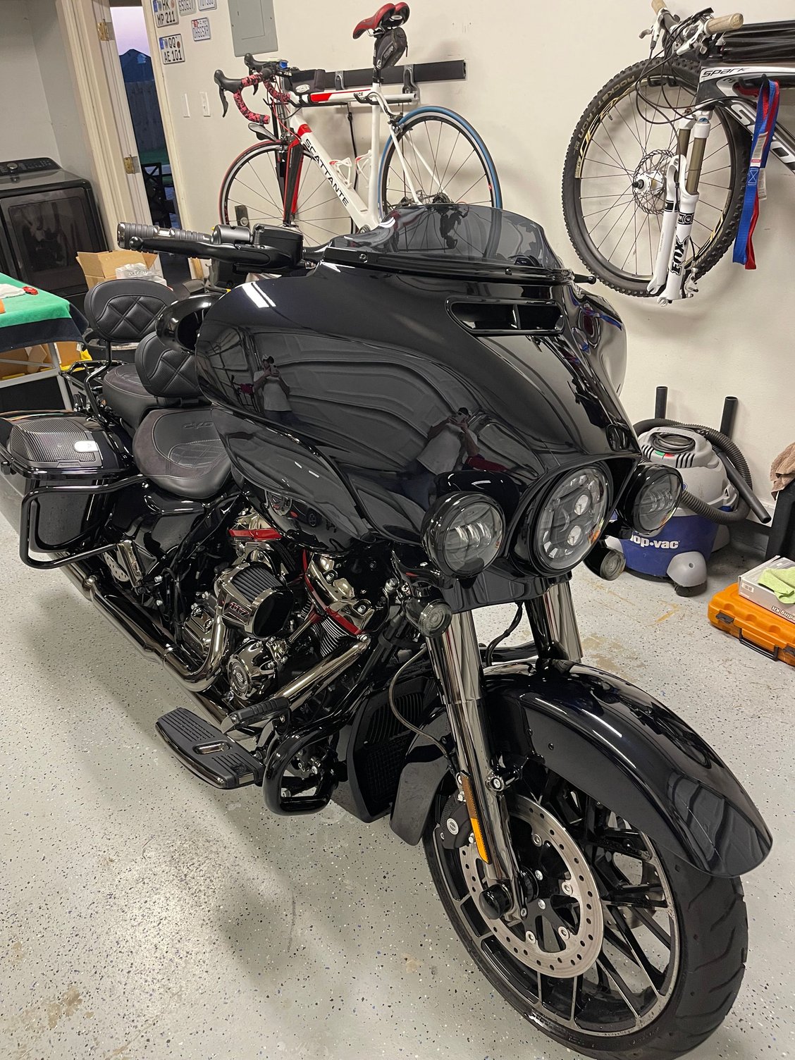

All buttoned up. Oh yeah!!
Still need to do a final adjustment to the lights
