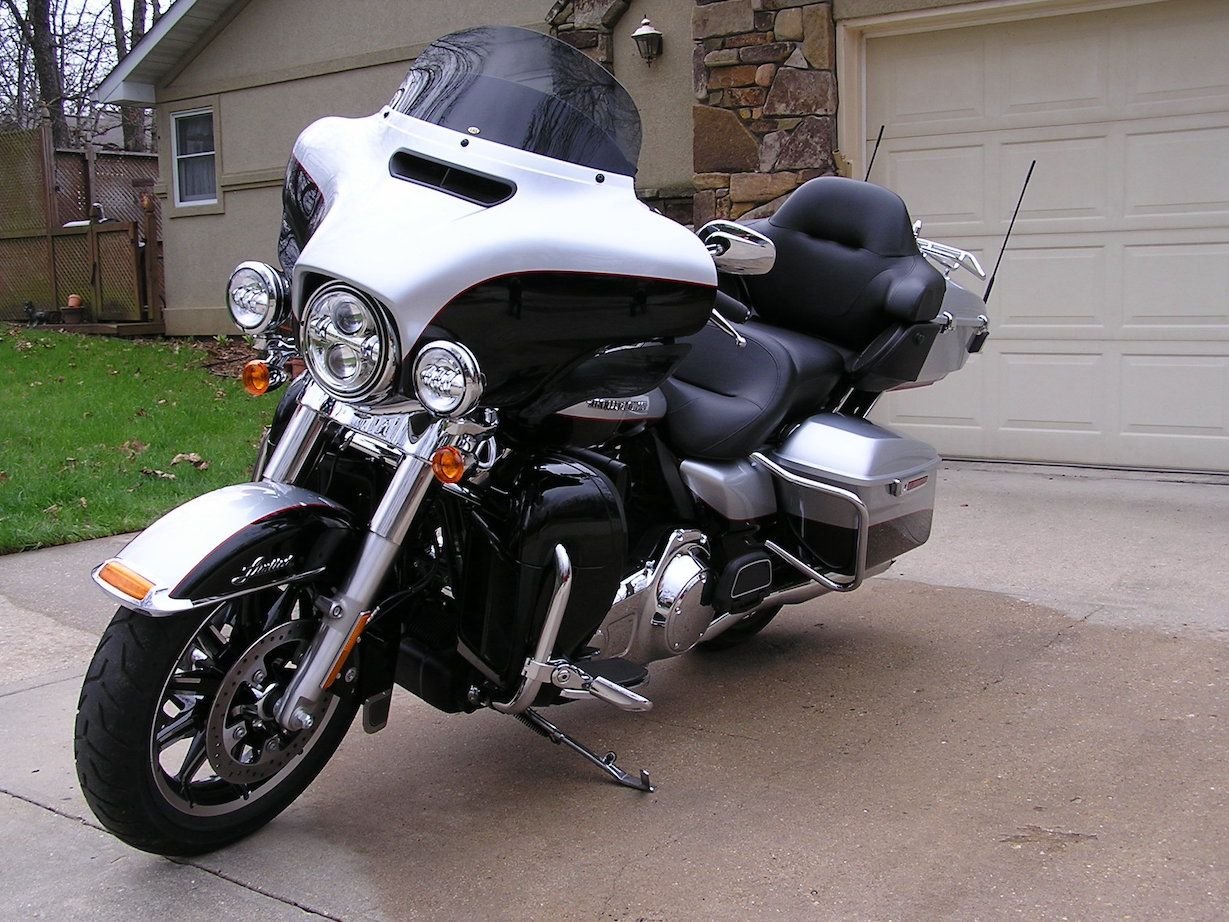

Here is what I am using, and I am very happy with it.
10" LRS medium tint.
I had the 12" version before, but didn't like it as much as this 10" one.
12"
10"
