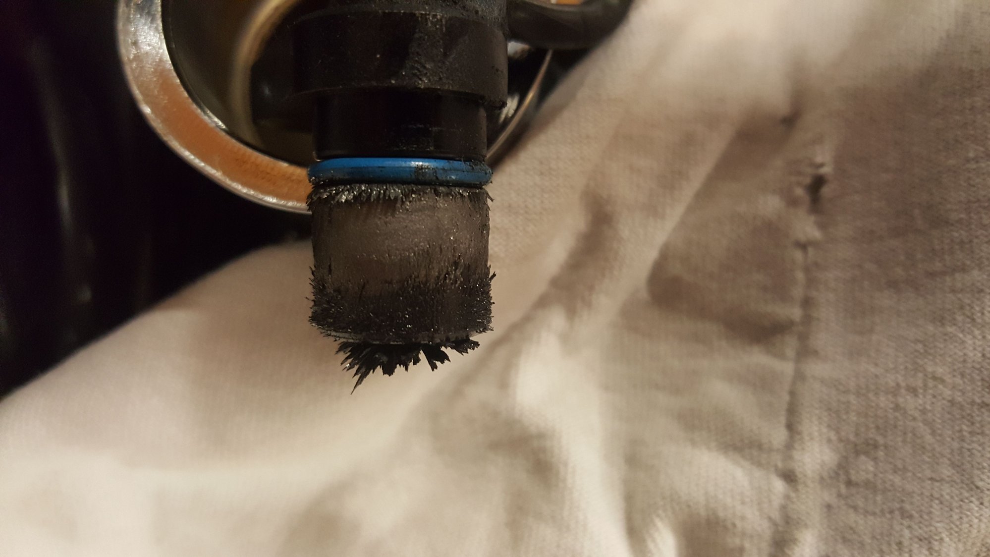

Clean the speed sensor that screws into transmission first

As "88" said.
Pull the speed sensor and clean the metal fuzz off of it.
My 2001 FLHR was doing a similar thing a short while back, and that was the easy & free fix. Only need an Allen wrench and paper towel.

I bet Bob's beer your speed sensor looks kinda like this..........
