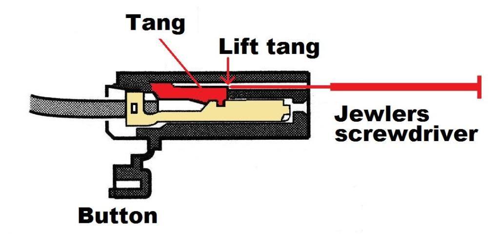

I found my P1510 and P2138 code problem to be a wire to barrel connector in the main connector to the ECM. So I have not figured out how to get the barrel out of the housing that holds it. Any tips to remove it so I can repair it.

This may be what you need.

Maybe but the hole is about the size of a small paper clip. Will the barrel pull through the hole the wire goes through. I have the connector down to 2 parts, gray and black and it looks like the parts will unclip but so far not very easy.

Usually the center part will pull forward about 1/4". Then you can use something to release the individual pin.

Yes, the wire and connector will pull through that hole. You'll need to pull the wire and connector backwards.

Thanks, I got it out. Now the thing has continuity out of the holder. I'm going to my local dealer and see if I can buy new barrel pins. I think I want to replace it because I didn't do anything to repair the open other than remove it. I was being too gentle with the release pin.
