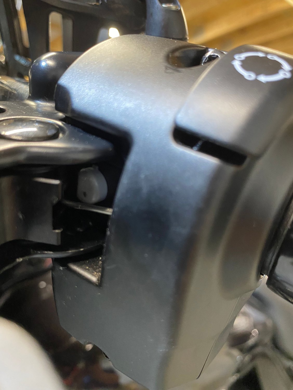

DefaultI have an update. I went out in the garage tonight and installed the clutch lever. After fooling with it for a bit, and forcing the self adjuster apart, the lever now has the correct end play. I also change how I had the torsion spring mounted (see the attached photo). You can just see the end of the torsion spring sitting at the bottom of the neutral safety switch. Like I said above there are no instructions included, just an exploded view illustration.
