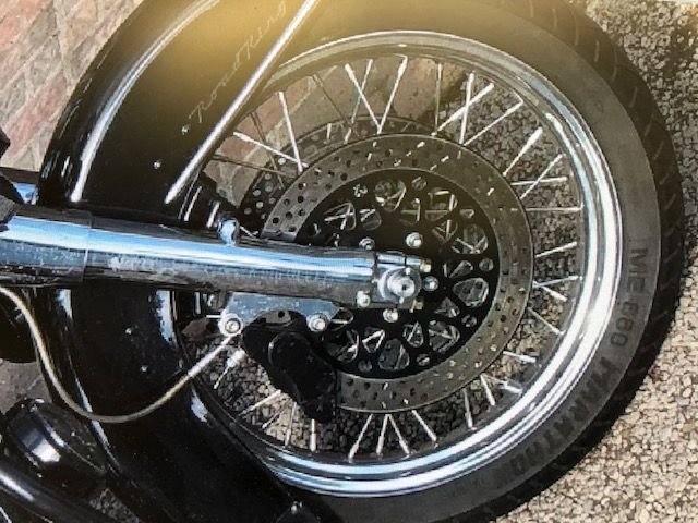

This is my '13 King with 21" fat spoke wheels. Only mod I had to do was elongate the back fender mounting hole to raise the back rear part of the fender a smidge to clear the tire. Everything else is stock, except for the rotors. I wanted to match the rotors with the wheels. Depending on how "wide" you want those white walls, you can go with a smaller rim and higher profile tire.
