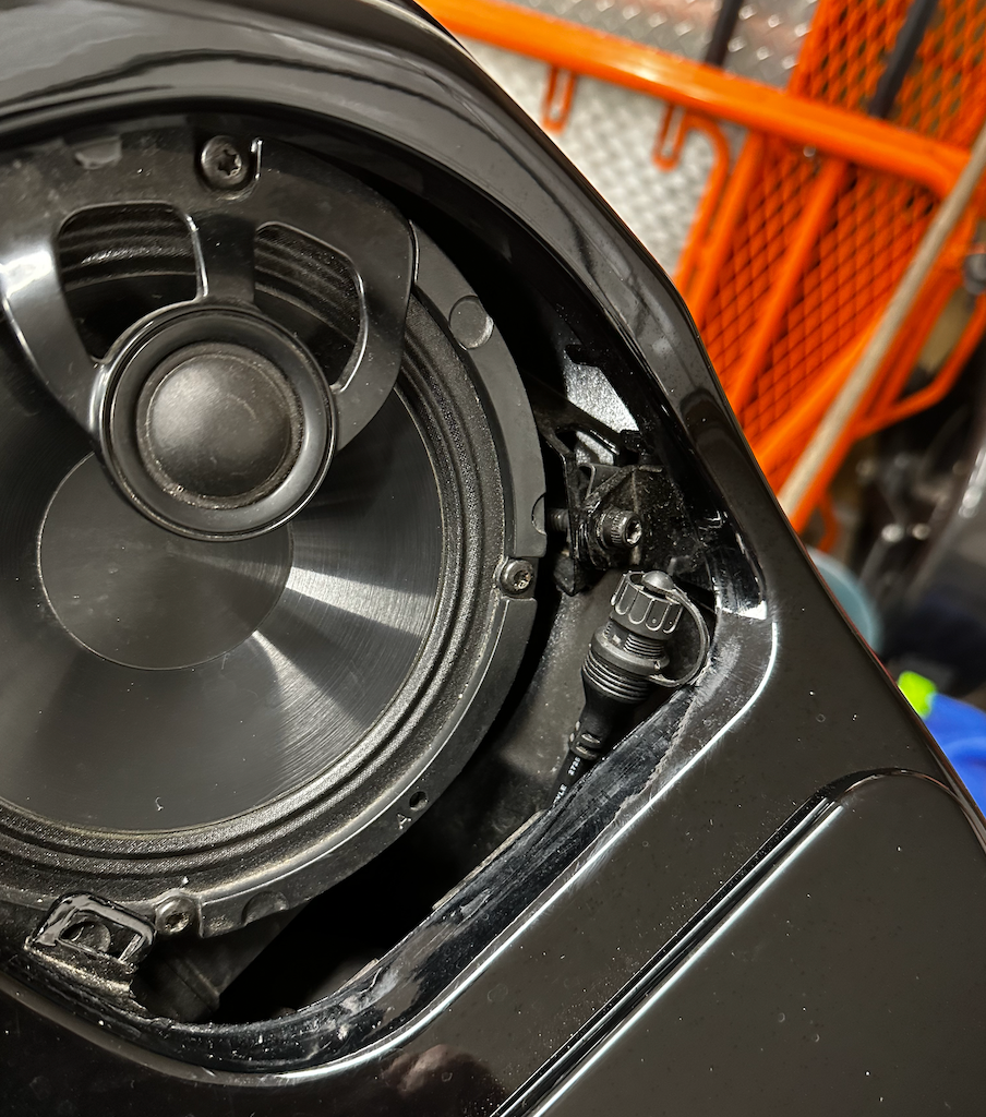

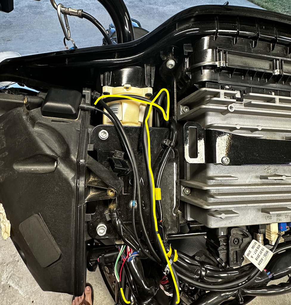

Originally Posted by skratch
not for the whim. if you follow the instructions for the install, the cable is routed to your right hand side cover. if, however, you don't see the point in removing the fuel tank to install the whim, some of us with roadglides have coiled the excess cable up and stashed it in the right side fairing speaker cubby.
i should note here that there has only been one upgrade for the whim since they've released it. so not something that you have to do often.
Skratch, do you have a pic of the rolled up whim cable in the speaker cubby? I'm installing a whim this week in mine and looking for alternative to under the right side cover as I have my Trask vent installed in there.
OP, not looking to hijack your thread, just needed a pic if available.
i just happened to have my fairing off yesterday doing something else so i was able to snag these pics for you. it's hard to tell with the spaghetti of wiring up there, but i drew a yellow line for you to follow. coming off the whim, across the top to a void next to the volt gauge where you coil up the excess, then over top of the voltage gauge, down into the speaker area.
