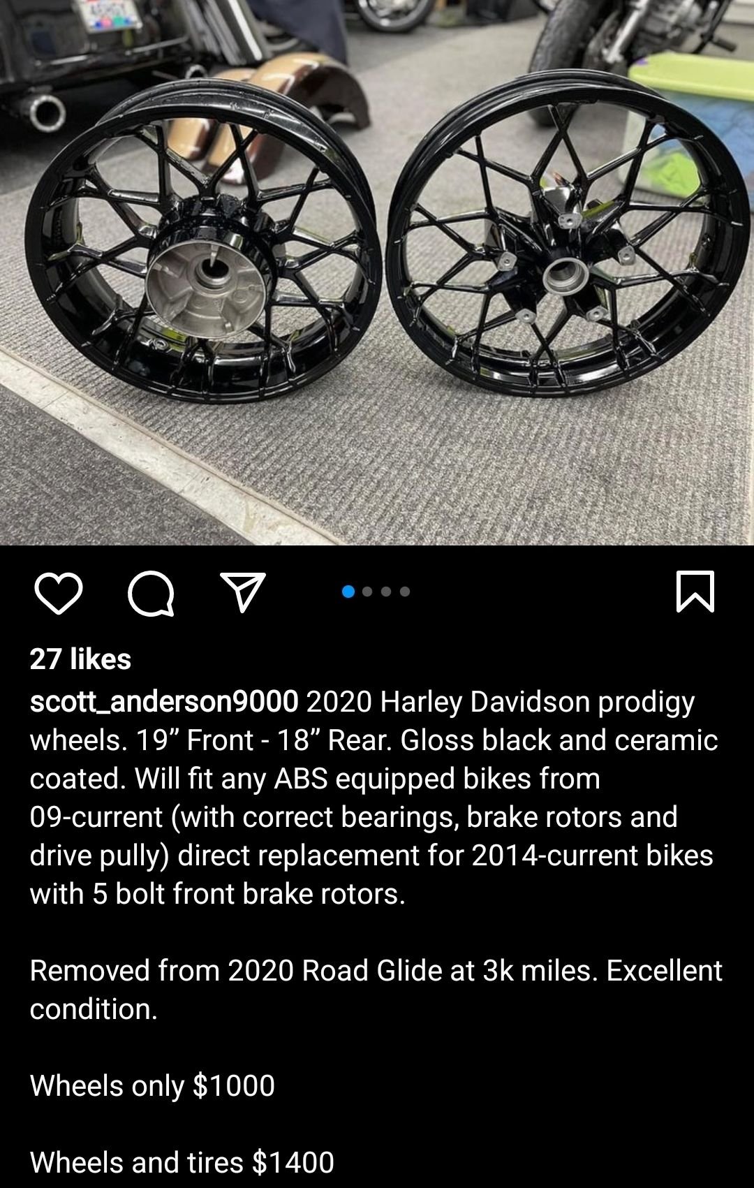

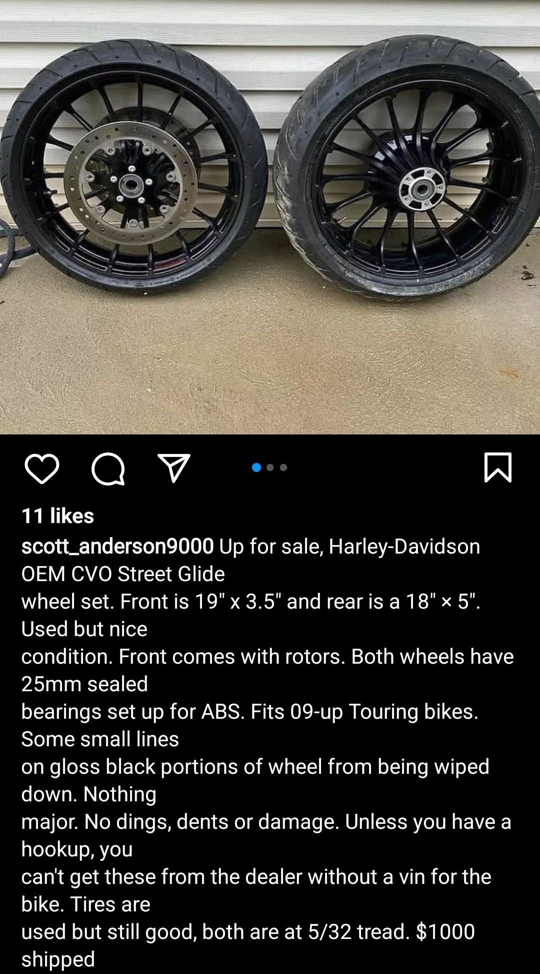

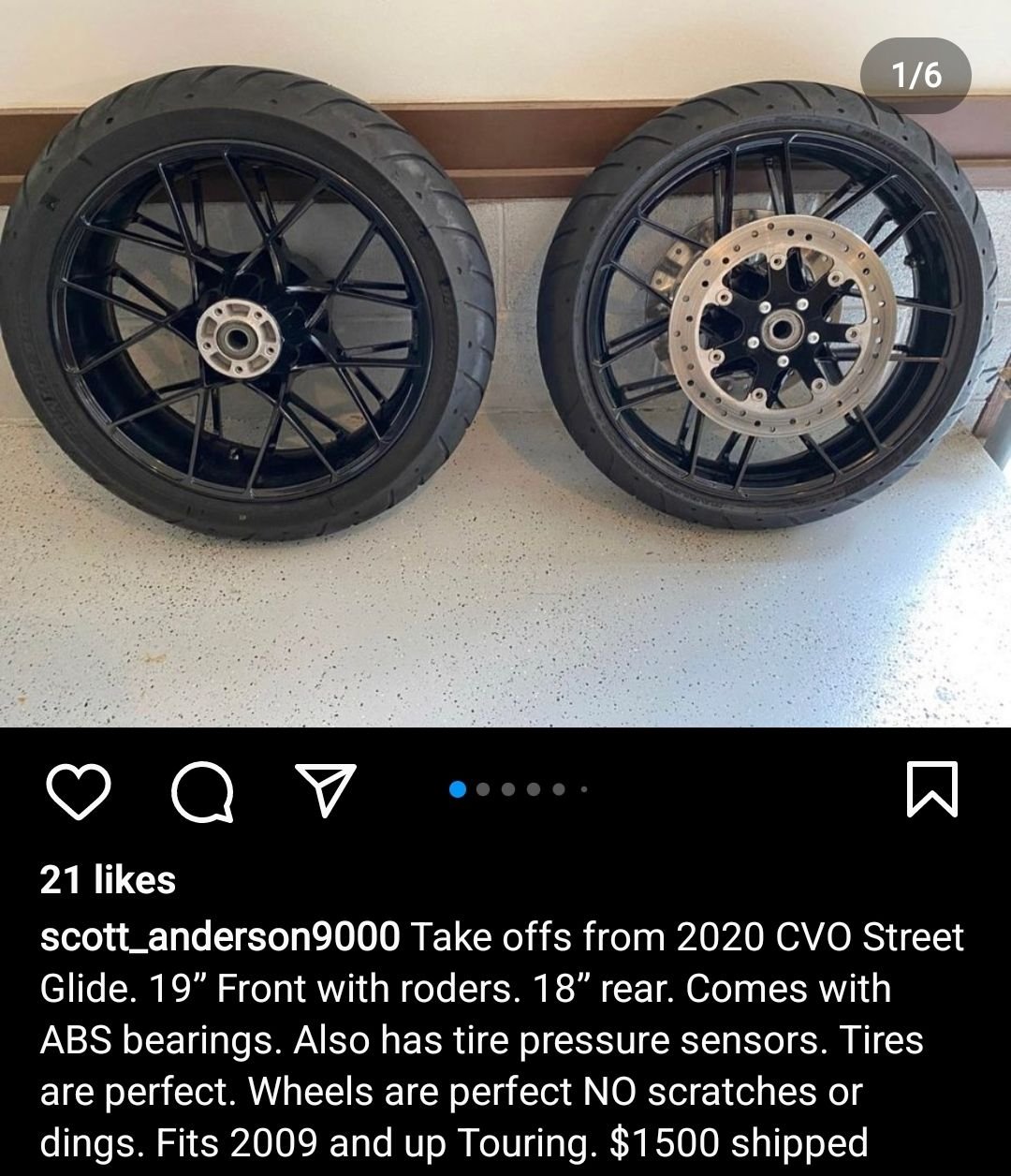

So 2009 up, same axle size. 2104 up they switched from hub to radial?
Here are some examples I'm looking at.
Old Sep 28, 2022 | 11:29 AM
NoRegerts's Avatar
NoRegerts
Joined: Mar 2011
Posts: 16,982
Likes: 9,059
From: Texas Hill Country
These first ones are what I have. But mine are powder coated not black.
Originally Posted by mrhammer2u
so 2009 up, same axle size. 2104 up they switched from hub to radial?
Here are some examples i'm looking at.
will fit
will not fit

I've never heard of "radial" mount rotors. I believe you are confusing that with radial mount calipers.
The two styles of rotors that I am aware of are hub mount and "spoke" mount.
Hub mount rotors are the smaller diameter of mounting location (mounting directly to the wheel hub)
Spoke mount rotors are the larger diameter outwards of the actual wheel hub (left wheel in picture - the right wheel is hub mount)
The rotor mounting will have no affect on a wheel fitting your bike, just simply whether or not you will need a different style of rotor based on the mounting.
