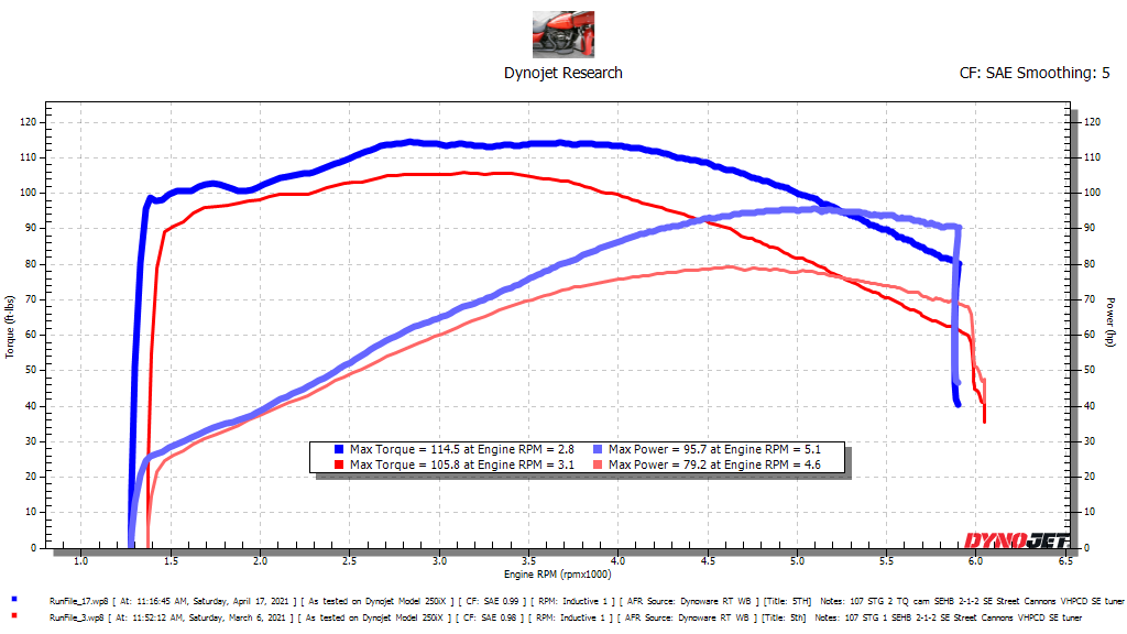

Just for reference, here's a B4 & after view of a 107 FLHX, using the SE tuner. The red run is stage 1 SE Heavy Breather AC, SE slip-on mufflers, V&H 2-1-2 head pipe. Blue run adds the SE447 Torque cam. Nice improvement, nothing earth shattering.

Not worth 2500 bucks IMO though. But the addition of a real tuner would net much better gains.

Why do they call the SE447 a torque cam when it does more to improve the Horsepower?

Because it makes less horsepower than the SE462 cam?
