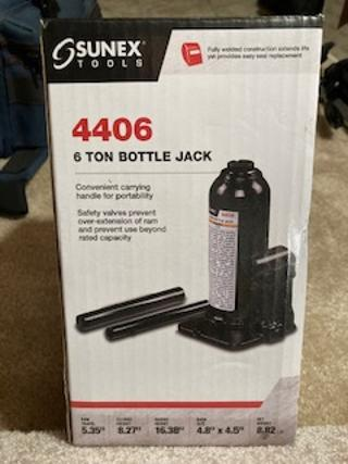

In anticipation of never getting the J&S replacement bottle jack, I began shopping for a replacement bottle jack that had a large enough BASE PLATE to drill through to fit the existing mounting plate on my J&S lift. I bought a SUNEX #4406 - 6 Ton Bottle Jack which has a large enough base plate for drilling and mounting AND has the same overall dimensions to fit the J&S lift. (now that I eventually received the replacement from J&S, I don't need the SUNEX but I'll probably just keep it for now, because it's heavy and selling it with shipping would be costly).

I did exactly this and it works great.

FYI.....It's a good idea to save the foot peddle and the "cuff" the foot peddle fits into IF YOU BUY the SUNEX. It's easy to transfer the "cuff" onto the SUNEX if you want to use your original foot peddle. Otherwise you'll need to use the 2-piece handle that comes with the Sunex.

that's correct, I just wish the **** worked with the new jack too.
