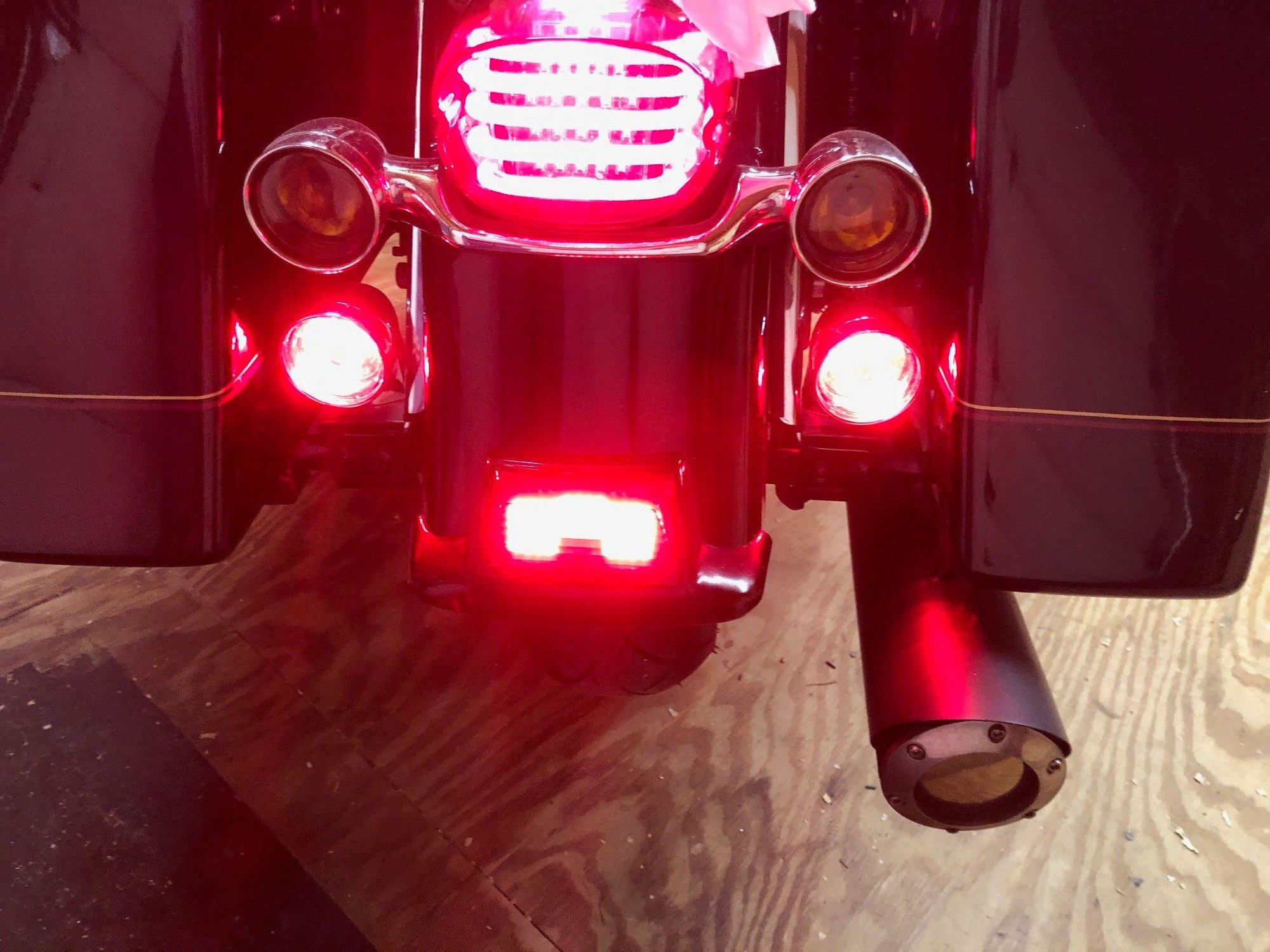

I believe H-D still offers the rear bar shown below to replace the moose antler ( 2013 Street Glide p/n 73314-10 )
You will need to relieve the reflector slightly to run "most" aftermarket LED bulbs
