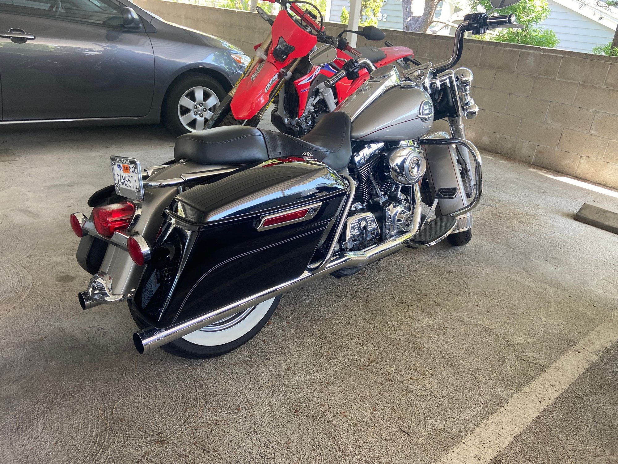

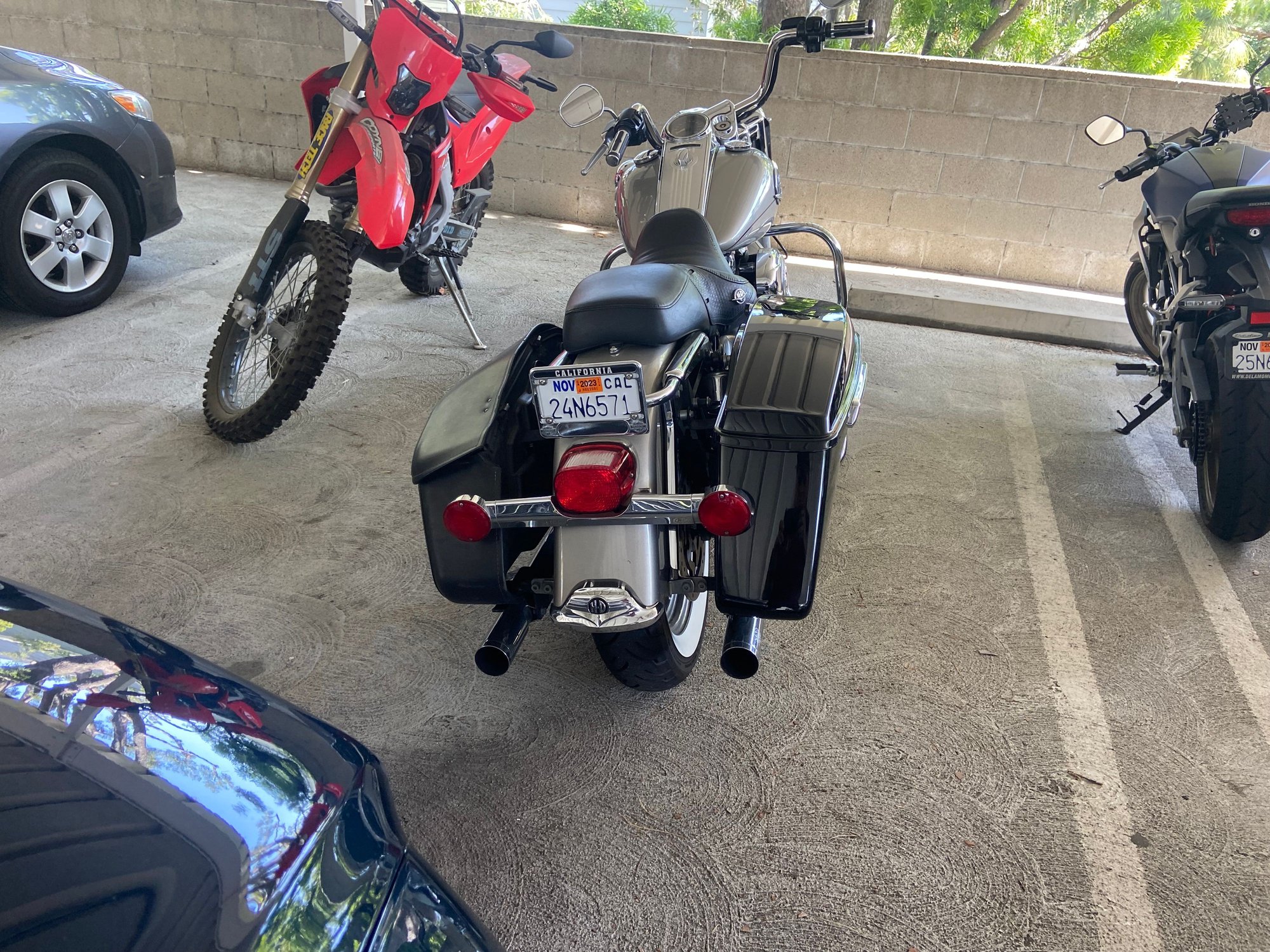

Can someone please post a link to converting a pre-2009 Road King to post 2014 saddle bags. Lots and lots of info on post 2009.
I have a 2008 RK and just picked up a set of 2016 RG hard bags.
thanks.

Disregard! All I did was add a 1” spacer to the front bracket and drill the hole 1” lower on the rear mount of the bag. Done and done.
