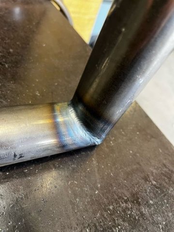

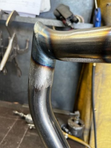

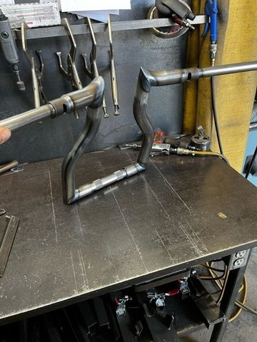

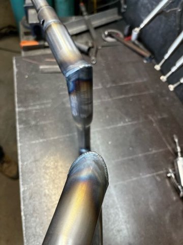

14", 5" Pull back, 31" across, leaving the welds in place and heading to powder coating.

This weld shows a solidification defect. That centre line in the weld and the more pronounced Vs say your welding speed is too high. The rest of it looks OK though. Easy to fix just run another pass over top with a little filler.

Bars look cool keep us updated.
