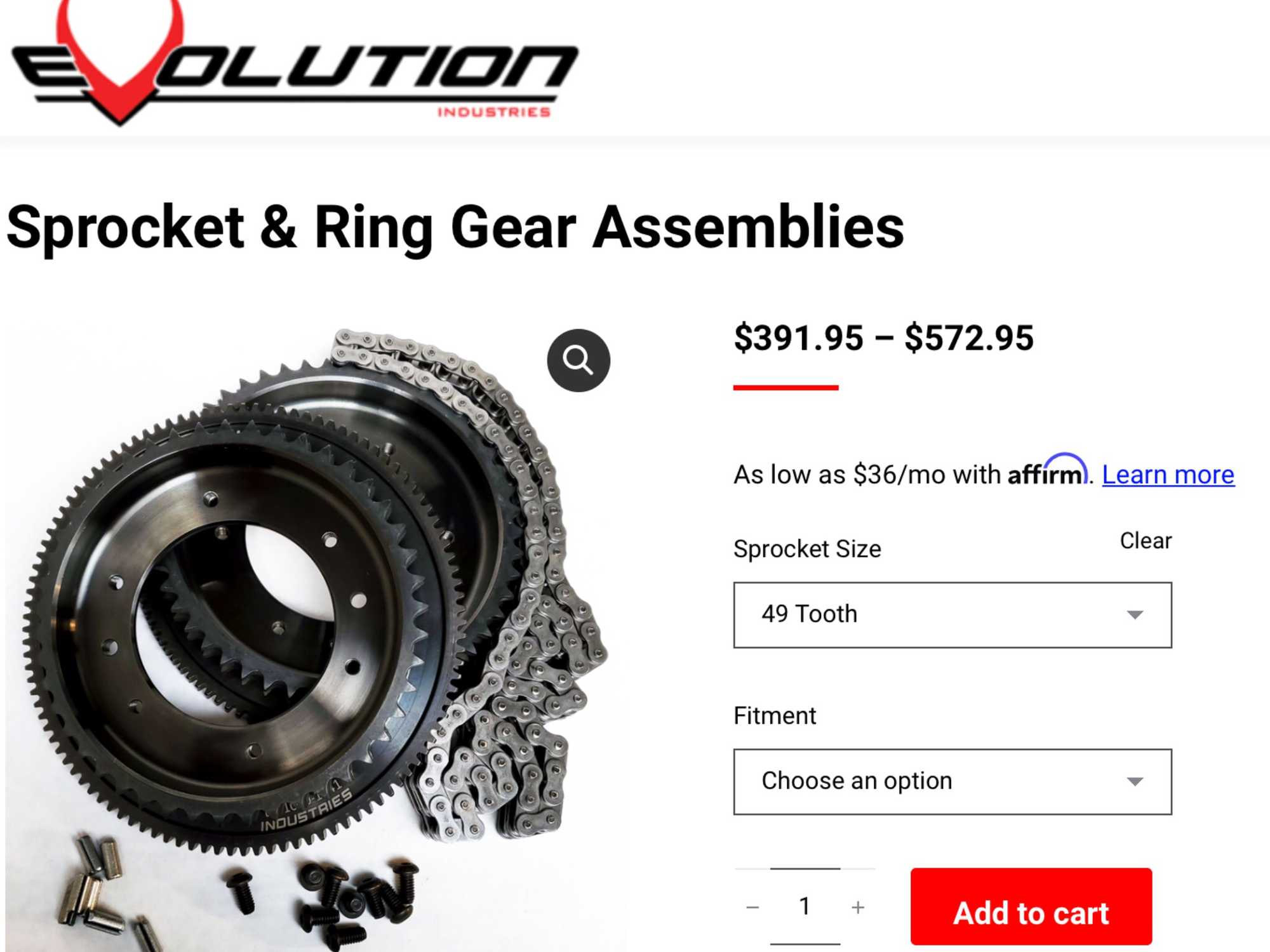

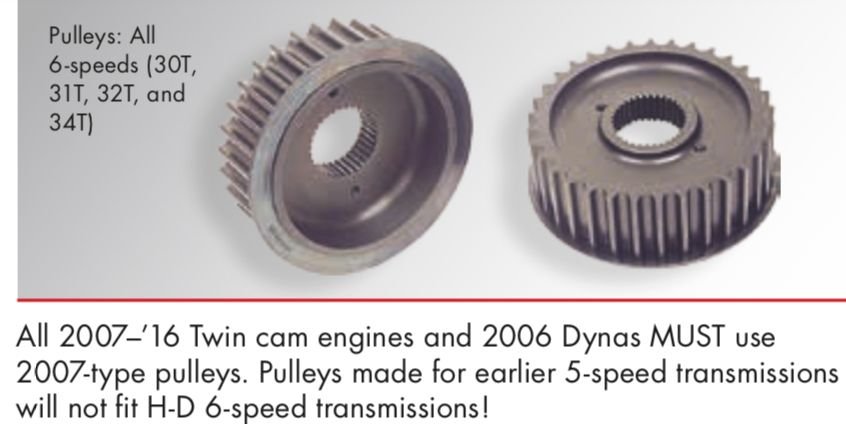

2.79 final gearing is too high,even with a good torque cam. 31 tooth Andrews pulley or an evolution industries 49 tooth rig gear is a good choice.
