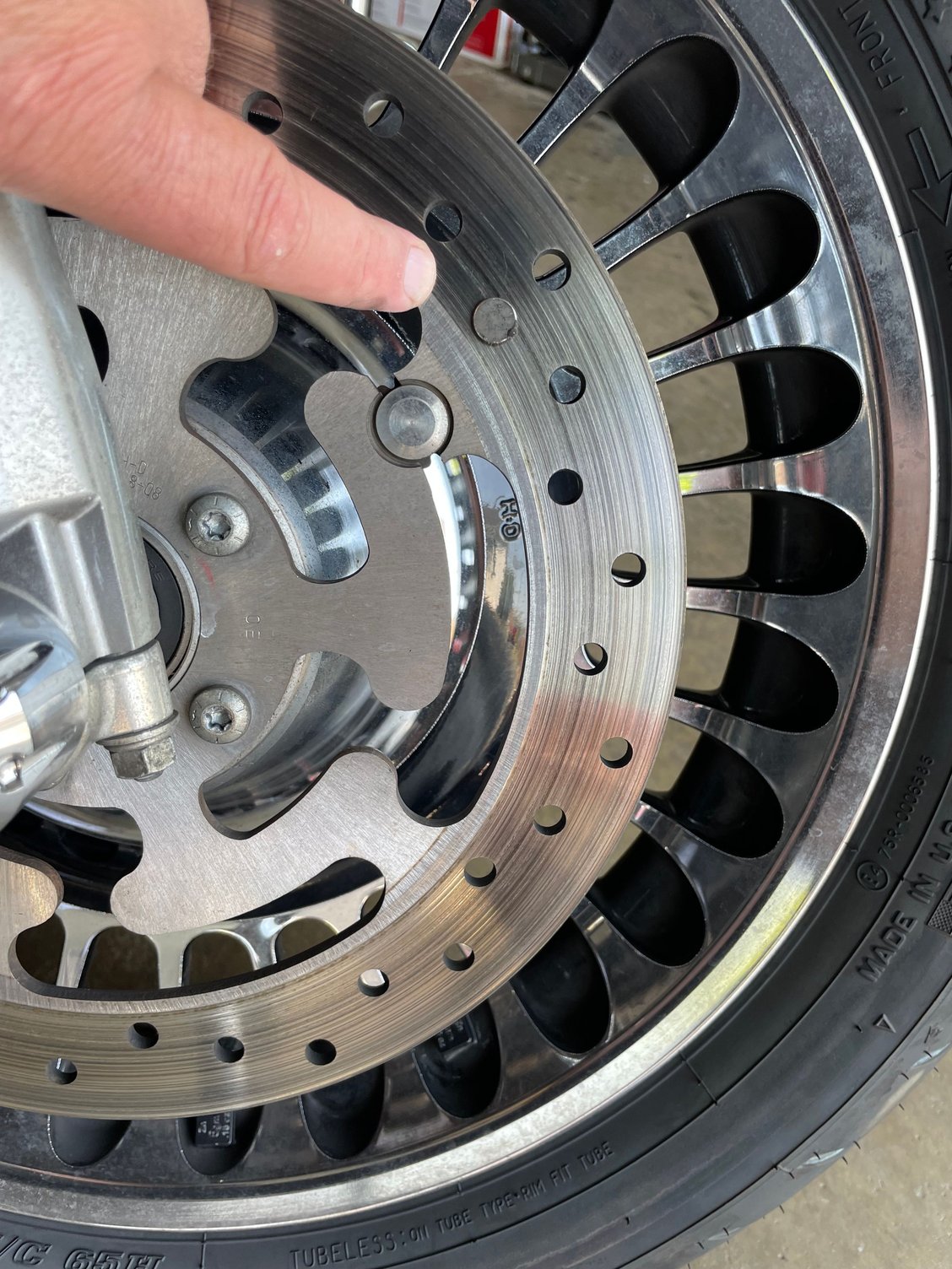

I took that magnet that I found on the rotor, threw it back on and took this picture just to give you guys a visual of what I was talking about in the previous post..
That magnet in your picture is placed directly in the friction/wear area of the rotor. Where was it (magnet) originally found? And by the way, I doubt that the magnet...with its very small weight and close to the wheel center...would produce a vibration based on weight alone. But if it was me and my bike, I would be in contact with the tire shop, AND I would probably pull the calipers to check them and the pads for anything unusual. I would also check rotor runout with a gauge. Somehow it almost looks like the magnet may have been 'riding' on the rotor and being pushed by the brake pad. Am I seeing things or is there actually a dark wear line running around the rotor approximately in line with the edge of the magnet?
This is where I found the magnet when I flushed the calipers out with a hose, in the wear area, I simply placed it back on the rotor in this photo to show it's size compared to the holes in the rotor. I doubt that it was riding in this area very long ( if any ) because there are no wear marks on either side of the magnet. I figure I flushed it out of the calipers and then found it on the rotor... but have no clue if it belongs anywhere on the bike .

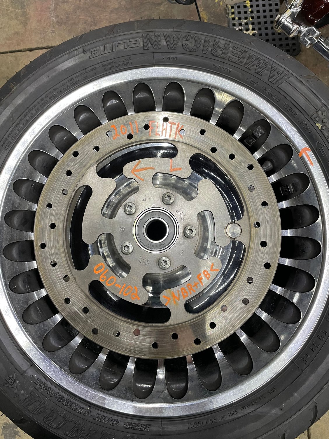

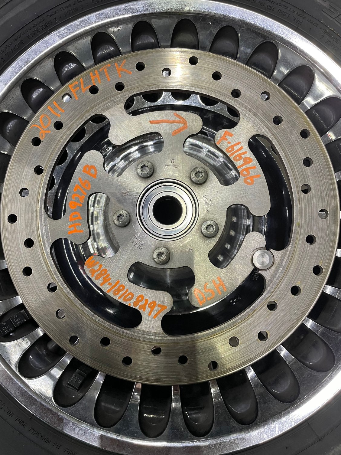

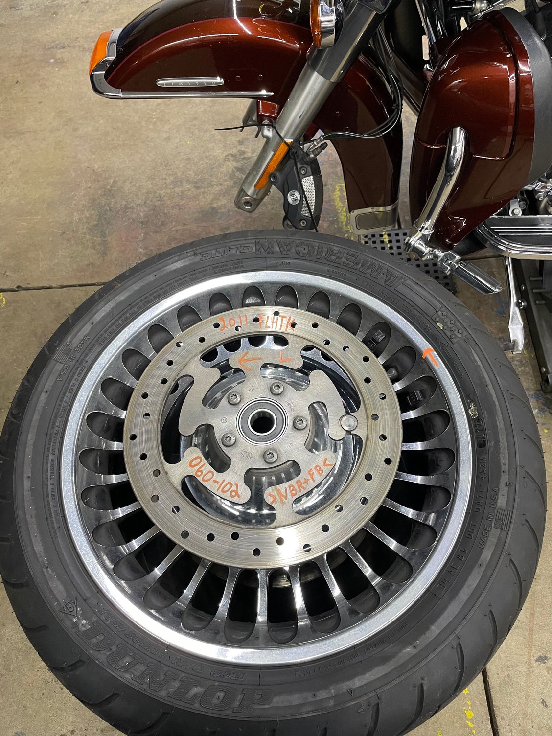

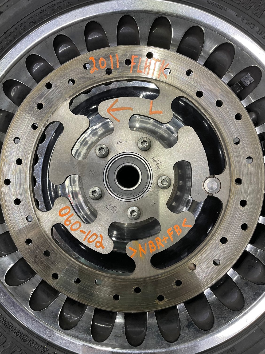

After putting about 600 miles on the bike I decided to pull the front tire off again and take it to a different HD dealership to have them re check everything out. They told me that they spun the tire up and it did in fact balance out correctly without having to add or remove any weights. They also told me that the bearings had some drag and was making a clicking noise when on the balancer so they replaced the front wheel bearings again with original HD bearings. ( the previous new bearings were from e-bay )
However, the new HD bearings do not look right to me, they look like the are installed inside out but what do I know. here are some pictures of the new HD bearings instaled at the HD dealership. The numbers in orange are the markings on the bearings .
Are these HD bearings in the right way ? the ABS bearing has a gray dust cover on the outside and the non ABS bearing has a metal cover on the outside ...
Left ABS side 2011 ultra limited
Right NON-ABS side 2011 ultra limited
