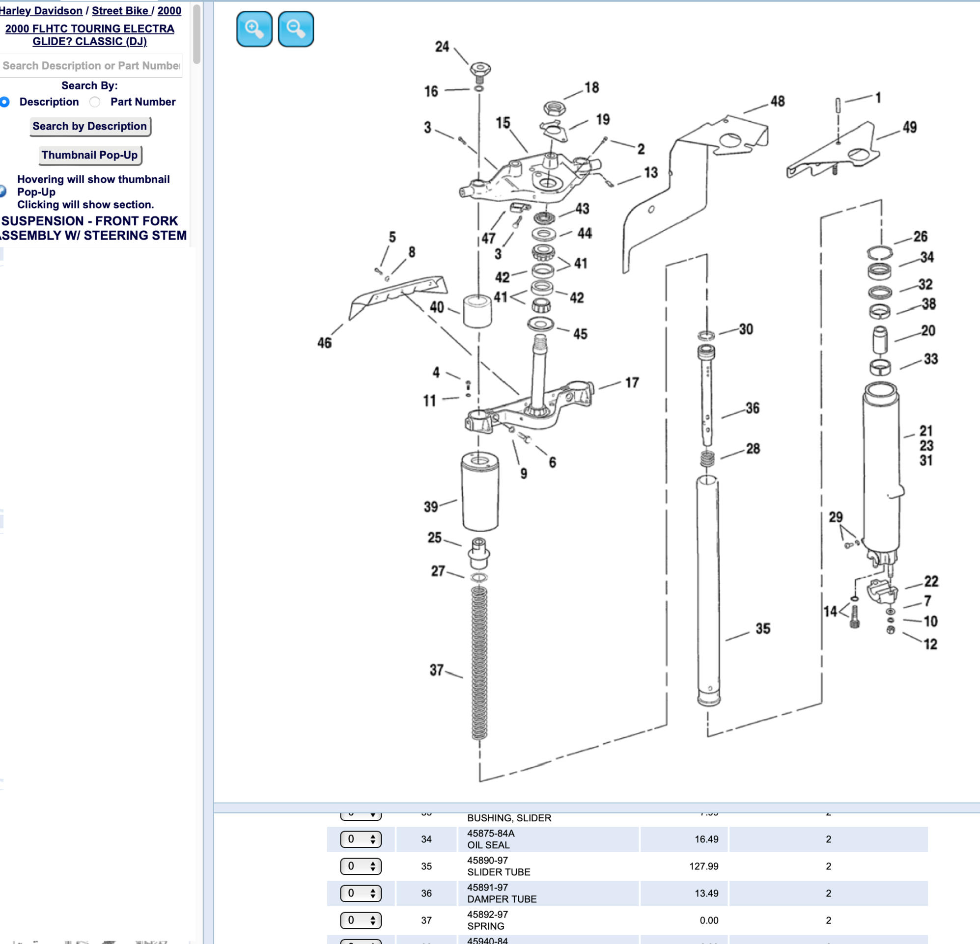

Is there an easy way to verify if my 2000 EG Classic is air for front suspension? I have a leak at the bottom of one of my forks and bought the rebuild kit but now I am reading air……🤷🏻‍♂️
Old Feb 27, 2024 | 02:56 PM
RKZen's Avatar
RKZen
Joined: Aug 2013
Posts: 6,090
Likes: 1,963
Welcome to the forum. The parts drawing below indicates what you have. Only the factory rear shocks have a valve stem for the air.
thank you! Do you have a link to the IPB? Would be extremely helpful with the exploded view!
