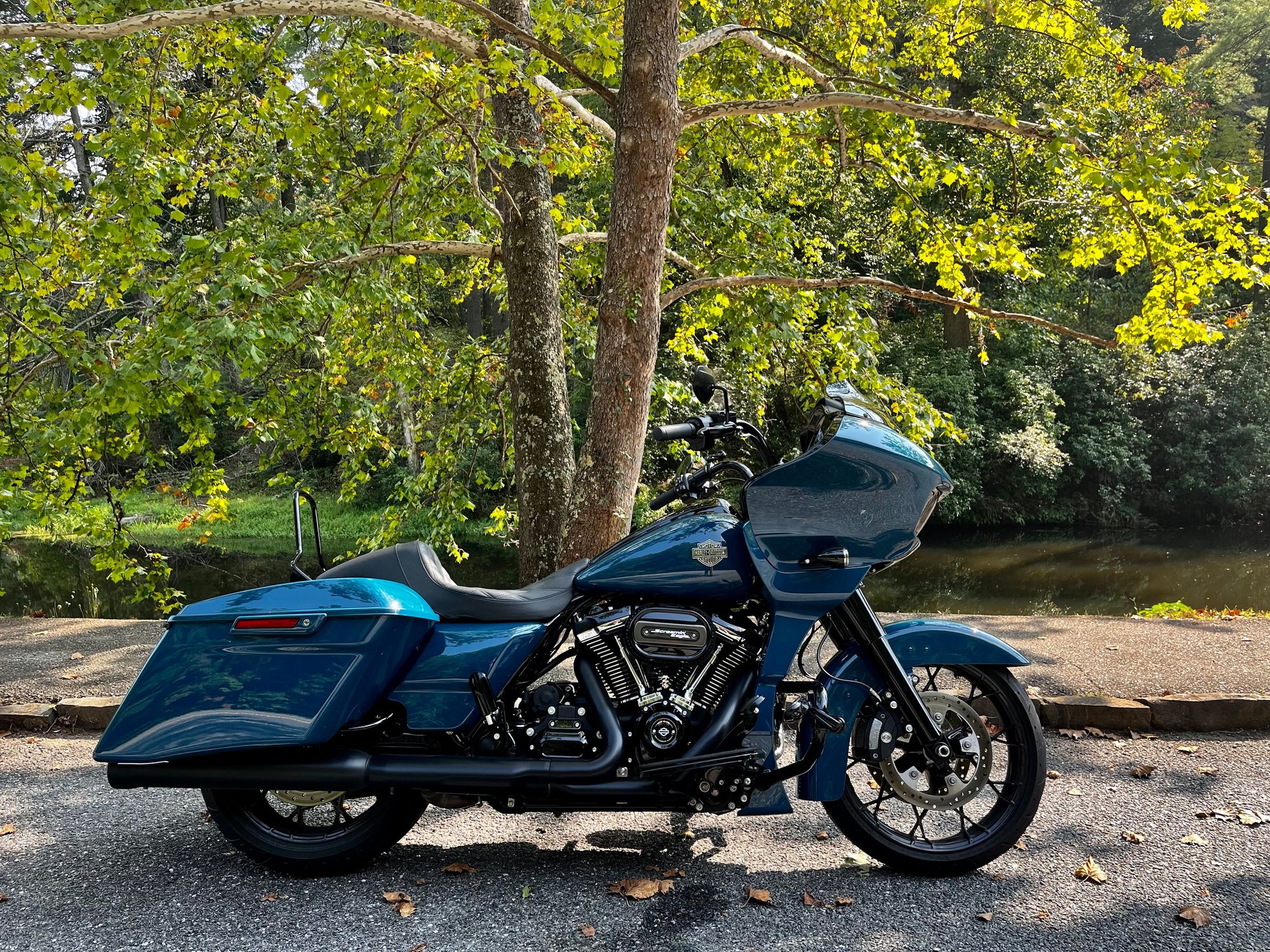

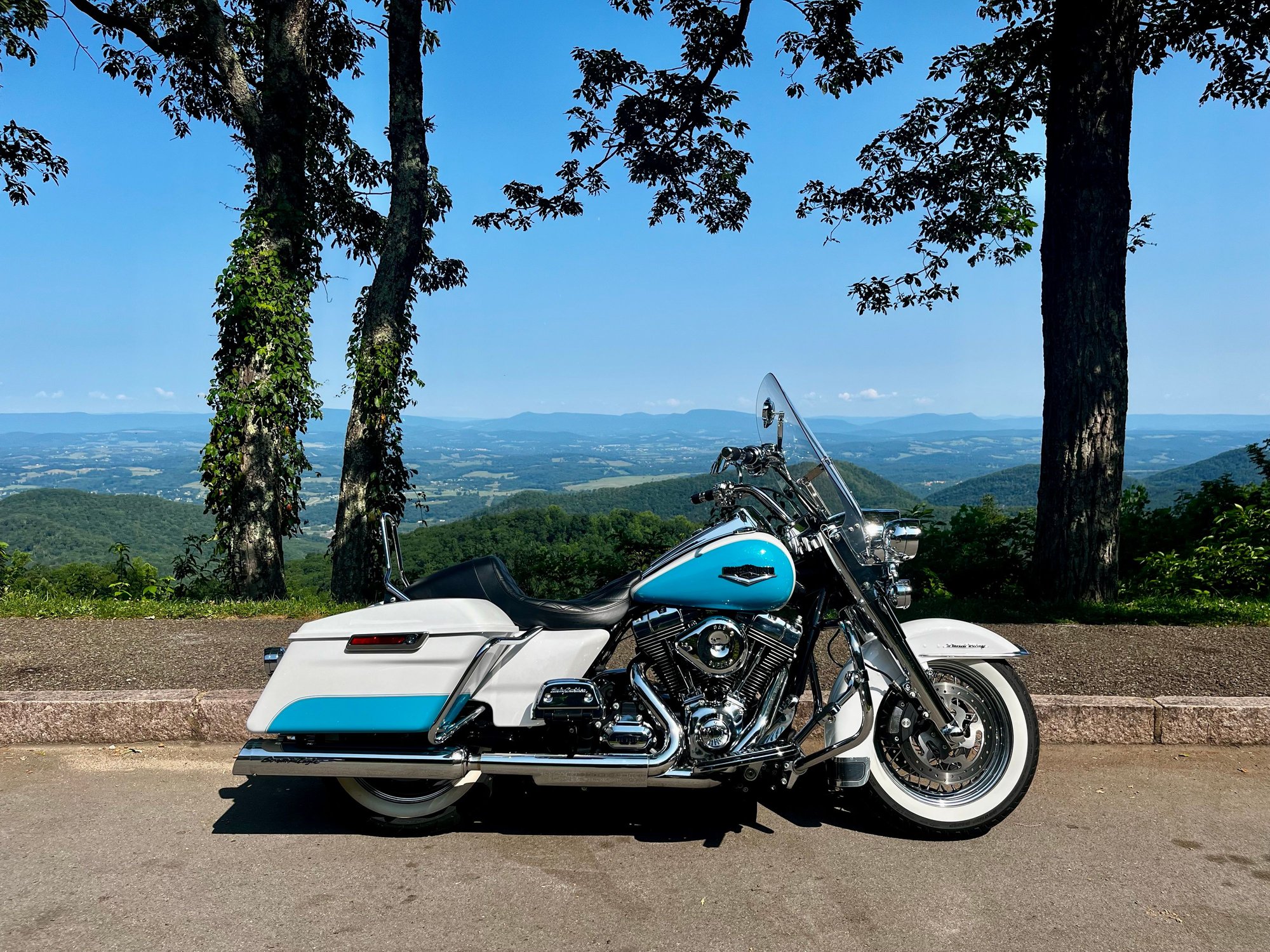

21 RGS and a 16 RK - there's a bit of apples and oranges as the RK has more sidewall and rides more plush while also being lighter. Both kind of suck in the turns, wallowing in the sweeps and not enough clearance in the tights.
I'd give the highway nod to the RGS, the fairing does a great job - both feel the same in high winds. Same setup, same Legend suspension, same Corbin seat - stock bar height. The RK feels a little better around town - but that's comparatively.
